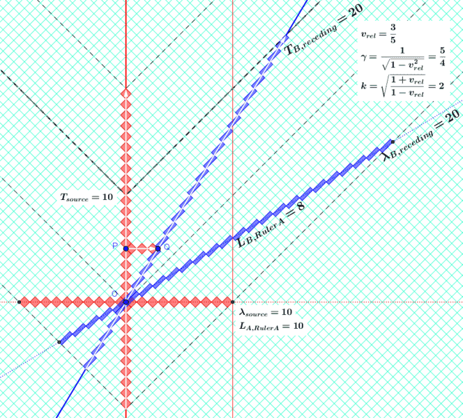

The Doppler Effect can be derived by using Bondi’s method. Radar methods are then used to connect the Doppler-Bondi k-factor with time and position displacements, and thus relative velocity measurements to get the Doppler formula: ##k=\sqrt{\frac{1+v}{1-v}}##. Along the way, one can derive the Lorentz transformation... but it’s not necessary to obtain the doppler formula with Bondi’s method.
In addition, it might be useful to draw a Spacetime diagram of the wavefronts of a periodic source. Then consider the observations by other various inertial observers... in both the relativistic and nonrelativistic cases.
For special relativity, a key detail that is often neglected is that length contraction involves the separation between parallel timelike lines, whereas the Doppler effect as applied to wavelength applies to parallel lightlike lines. Thus the length contraction formula does not apply to wavelength as if it were a ruler-length.

  • #56
Not sure if this will help resolve the stubborn misapplication of length contraction, but here goes.
Previously Dale suggested you simply use the Lorentz transform, and I suggested specifically transforming x=ct and x=ct+L to see what really happens to L in this case (hint: it does not contract).
I propose to do this generally to see how standard length contraction is a very special case.
Consider x = u t and x = u t + L in some inertial frame in standard coordinates, where u may be any propagation speed. In particular, u=0 implying rest in the starting frame gives rise to standard length contraction, while no other case does. We boost these equations to a primed frame moving v in the +x direction, using the Lorentz transform. With a fair bit of algebra, the following results:
x' = u' t' and x' = u' t' + L'
where u' = (u-v)/(1-uv/c2) i.e, velocity addition formula and
L' = L / (γ (1 - uv/c2))
Note that u'/L' is the frequency, in all cases.
We see immediately that for u=0, you have L' = L/γ, simple length contraction.
However, for u=c we get after simple algebra:
L' = L √ ((1+v/c)/(1-v/c)) [of course, u' = u = c for this case, which falls right out of the general formula]
Another interesting case is u=v. This means the primed observer is moving with the wave (not possible for light, but possible for slower waves). Here you get:
L' = Lγ , i.e. the original frame sees contraction by γ compared to the moving frame - because the waves are at rest in the moving frame.
Yet another interesting case is where L' = L. This arises for:
v = 2u / ( 1 + u2/c2) or equivalently u = (1 - 1/γ) c2/v ; note, this equivalence is quite messy to show.
What does this case mean? It is when v is such that the wave traveling at u in the original frame, is traveling at -u in the primed frame. Thus, it is perfectly expected that the wavelength is the same as the original frame. However, due to nonlinear velocity addition, v is not 2u for this case, but the more complex expressions just given. An example of this case with round numbers is u = c/3 and v = .6c. This gives u' = -c/3 and L' = L.
You can see further that for u and v small that L' ≅ L, and speed and frequency approach Newtonian values.

My reply in #35 suggested that you draw a spacetime diagram.
(Now that I have a little free time)
I will now follow my own suggestion try to draw the situation on a spacetime diagram.
I've drawn the spacetime diagram on rotated graph paper so that one can easily see (and count!) the tickmarks along the various segments.
Alice (at rest) is the periodic source of light signals with period 10.
Bob travels with velocity 3/5.
An observer measures "length" using that observer's spaceline of simultaneity (which is Minkowski-perpendicular to that observer's worldline).
Suppose Alice has a ruler of length 10, interpreted as "where Alice says the wavefront of the previous signal is located when she emits the next signal".
Note that this "x=10 location in Alice's frame" has a worldline parallel to Alice's worldline.
The "length of a ruler" is the spatial separation between two parallel timelike worldlines.
The "wavelength of a light wave" is the spatial separation between two received wavefronts (i.e. two parallel lightlike-lines).
The "period of a light wave" is the temporal separation between two received wavefronts.
The "wave-speed" equals wavelength/waveperiod.
So, Alice says the length of my ruler is ##L=10##, ##\lambda_{source}=10##, and ##T_{source}=10##.
Since Bob is in relative motion, according to special relativity, his sense of simultaneity is different from Alice's.
(In Galilean physics, his sense of simultaneity is the same as Alice's... in that case, Bob will measure the same wavelength and same ruler length as Alice did.)
So, Bob measures Alice's ruler to be ##8=\frac{10}{(\frac{5}{4})}## units long (length contraction) and
the wavelength to be ##20=10(2)## units long (Doppler effect for receding receiver)
and the period to be ##20=10(2)## units elapsed (Doppler effect for receding receiver).
Thus, the wave-speed=##20/20=1.##
[For the approaching case, you can see ##5=10/(2)## units for wavelength and period, and thus wave-speed=##5/5=1.##]
Now, one can try to write down the "equations" and interpret the "variables" suggested by the diagram.
The equations are actually relationships of the sides of various triangles in this diagram.
