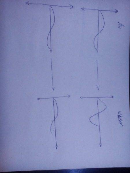

Frequency has nothing to do with what medium the wave is traveling through, it's only related to the source.
See it this way: a EM full wave is produced when a charged particle goes up, down and once again up to the previous position... Now when it reaches a higher density medium the wave doesn't disappear, it just moves forward more slowly.
In the image I think you can see it more clearly:
On the top is when frequency is unchanged and on the bottom is when frequency is changed. In the same period of time part of the wave is not produced yet
I hope I made sense :)
PS: I know, I messed up and wrote whater first then fixed it XD
Hand-drawn diagram of two rows of wave sketches, labeled Air at top and Water at bottom, with downward arrows linking the rows; wavelength shrinks in the water panels.
  • Hand-drawn diagram of two rows of wave sketches, labeled Air at top and Water at bottom, with downward arrows linking the rows; wavelength shrinks in the water panels.
