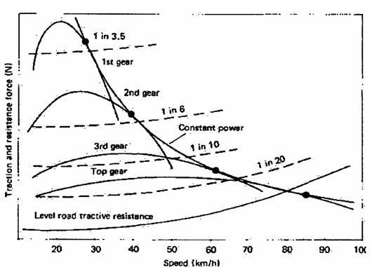

An important point that I don't think anyone mentioned is the power graph of engine performance. When you rev the engine with the clutch disengaged you bring the RPM up which dramatically increases the available torque output of the engine. Revving the engine up, releasing the throttle, and then popping the clutch would only chirp the tires and then the engine would likely stall. (Unless you have a large rotational mass compared to vehicle weight) Flooring the throttle and dumping the clutch as the engine reaches peak output produces optimal difference between torque at the flywheel and static friction at the tire/road contact patch(es).
I agree. And if they are not considering this, they are not talking about a real car -- they are talking about some fictional vehicle.
The engine torque curve does not increase with low RPM. It decreases significantly. At a fixed gear ratio, that gives decreased torque available at the tires. The slipping of the clutch allows the engine RPM to be higher than the first gear ratio would otherwise allow.
That's exactly it - with a slipping clutch we can effectively modify the otherwise fixed gear ratio.
And we can get close to delivery of the maximum power of the engine at any speed, which is how we obtain maximum sustained acceleration.
And yes, when fully engaged, an engine can provide limited power at low speed in a given gear ratio, which leads to stalling.
But that's not what we're doing at extremely low speeds, which is why such graphs always begin at a certain minimum speed.

The engine and clutch work together to allow the engine to stay at a high-torque RPM while the clutch slips and turns the wheels through the fixed gear ratio. That is more complicated than saying that the gear ratio has been effectively changed (It has not been changed.). And it is very different from the F = P/v equation.
In my mind it might help simplify the problem by saying the gear ratio from the clutch disk to the drive wheels is constant and the percent of torque transfer from the flywheel to the clutch disk is variable...

I agree that a slipping clutch is not a gear reduction. If you examine it as a free body, the torque in equals the torque out. However, the power in is not equal to the power out, due to the shaft speed differences. The rest is lost to heat. Even the common torque converter can only double the torque, and that's only because it has a stator contacting the transmission housing.
For a reference, I discuss this very thing in the book mentioned in my signature.
Likes Greg Bernhardt, jerromyjon and FactChecker
  • #35
Randy Beikmann said:
While it's true that P=Fv, that only applies to the power applied to the road, not necessarily the power the engine is producing. It would take an infinite gear reduction to actually produce a large amount of power (actually any power at all) at the tires when stationary.
I agree. And it is a mistake to treat P = Fv as though P is constant as v decreases and therefore F increases. In fact, engine torque decreases as the engine RPM goes below the point of highest torque. So F decreases and P decreases even more. The wheel spin from popping the clutch is primarily due to inertia of the mismatch between engine RPM and wheel RPM through the gear ratio of first gear.
PS. I disagree with a prior comment (I forget where) that most cars can spin the wheels without popping the clutch. I think that most can not.
Likes Randy Beikmann and jerromyjon
