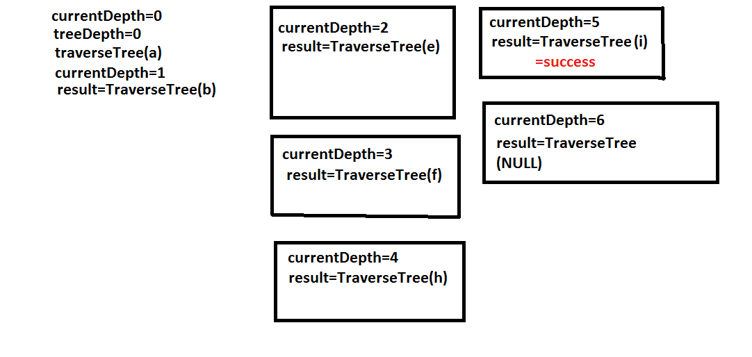

Applying the above algorithm at this tree :
I got the following:
currentDepth=0
treeDepth=0
traverseTree(a)
currentDepth=1
result=traverse(b)
currentDepth=2
result=traverseTree(e)
currentDepth=3
result=traverseTreef)
currentDepth=4
result=traverse(h)
currentDepth=5
result=traverseTree(i)
currentDepth=6
result=TraverseTree(NULL)
treeDepth=6
But, then result doesn't get any value.. (Worried)
At the case when [m]treeDepth=0[/m], do we have to return success? (Thinking)

So, if we want to trace the algorithm, I tried the following:
Is it right? If so, how could we continue? (Sweating)
  • #42
That looks right, although I think the success should be at depth 6.
At that point, we store the currentDepth in treeDepth.
And then we go back up, and then down into the next child.
Or rather, we keep backing up, until we can go down again. (Wasntme)

At the beginning, we get that the depth of the tree is 6, but, actually it is 5, or not? :confused: Is this a problem? (Worried)
  • #52
evinda said:
When we have, for example, this tree:
we call the functions [m]traverseTree(a,depth), traverseTree(b,depth+1), traverseTree(e,depth+2), traverseTree(f,depth+3), traverseTree(h,depth+4), traverseTree(i,depth+5)[/m], right? But.. what do we do after the command [m] return; [/m] , that is executed at the function [m]traverseTree(i,depth+5)[/m]? (Worried)
evinda said:
We want to check if all the leaves of the ordered tree are at the same depth.
Isn't the number of edges between the root and the deepest leaf $6$? (Wondering)
  • #53
Oh, yes you are right... (Tmi)
But.. when [m] treeDepth [/m] gets the value [m] 6 [/m], we don't pass through the longest distance from the root to the deepest leaf, but we execute the following commands:
currentDepth=0
treeDepth = 0
traverseTree(a)
currentDepth=1
result=traverseTree(b)
currentDepth=2
currentDepth=3
result=traverseTree(f)
currentDepth=4
result=traverseTree(h)
currentDepth=5
result=traverse(i)
currentDepth=6
result=traverseTree(NULL)
treeDepth=6
Or am I wrong? (Sweating)
  • #54
currentDepth=0
treeDepth = 0
traverseTree(a)
currentDepth=1
currentDepth=2
currentDepth=3
currentDepth=4
currentDepth=5
result=traverse(i)
currentDepth=6
treeDepth=6
That is true.
This is the depth of the non-existing NULL child of $i$.
If it would exist, it would be at depth 6.
The deepest actually existing node in this sub tree is $i$ at depth $5$. (Wasntme)
