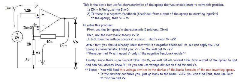

For the circuit below, find Vx and Vo.

You need to show some work before we can help. What are your thoughts about this problem? Look at some of the examples (links) in this https://www.physicsforums.com/showthread.php?t=131943 to get some ideas of how to construct your post.
I sugest you don't just remember the formula...try to understand the concept and the core characteristic...so that you can solve the harder problems...then you will love this thing.
Please see the attached for this problem and let me know if you have further questions.
Remember try to understand the concept...don't just try to remember it.:smile:

Always start by identifying configuration/mode of operation the OP-AMP is working in.Then begin accounting for each resistance till you reduce it down to an expression...
An OP-AMP is basically a high gain amplifier...you'd do good to find out the gain since the output is essentially a magnified version of the input,either same phase or inverted...I'm just done with a whole semster of OP-AMP's and timers...it's not as bad as you think:)

To check: Basically Vo= Vplus-Vminus. The voltage at Vminus is set by the resistive divider. So is the voltage at Vx
