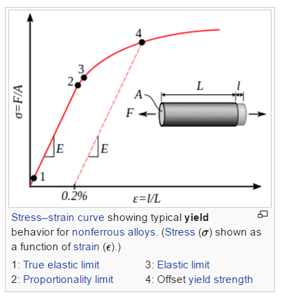

You probably should start asking for references for all this stuff you are being told.
Here is a discussion of what yielding actually consists:
https://en.wikipedia.org/wiki/Yield_(engineering)
There is a force applied, it is just that in the non elastic or idealized plastic region, it doesn't have to increase from the force required at yield (it doesn't follow Hooke's Law) and it sometimes decreases at the higher strains, but it doesn't go to the 0 or 'no force' condition.

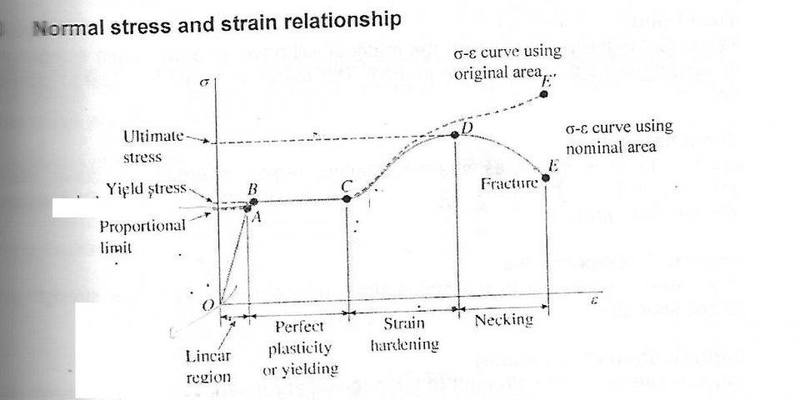

I have 2 graphs below, to show the yield point, in the first graph, the stress is constant from point B to C (C is yield point)(B and C are at the same level of stress), that means the force is constant,right?
For the second diagram, the yield point is slightly higher than the elastic limit point...Which of it is correct?

The first diagram is for materials like steel and the second is more like for materials such as aluminum. They are both more or less correct.
