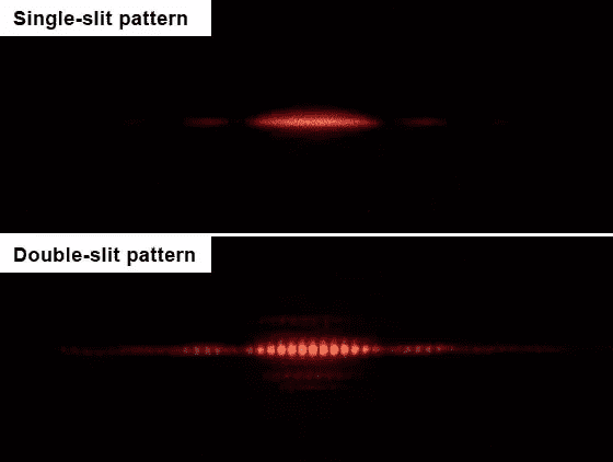

Hello, I have a question about the blue waves coming from sources S1 and S2 in de next picture.
The blue waves from sources S1 and S2, are those two resulting waves (interference of all wavelets, Huygens Principle) or are those blue waves two wavelets?

If this is high school (or elementary college ) physics...
The waves S1 and S2 are treated as two wavelets or two sources.
We use Huygens theory to explain why we get interference from a single source or single slit.
However, if fact, if you look closely at the double slit pattern, you will see that in fact, it's a double slit pattern superimposed on a single slit pattern, so in fact the two effects are present - each slit acting as a single slit according to Huygens, but then with interference between the two slits on top of that.

The blue lines on the diagram are just the wavefronts of the waves from each slit. Sure, you can think of every point between the edges of the slit as an emitter of wavelets (as you can every point on an existing wavefront), and each wavefront results from the overlap of lots of individual wavelets. That's how Huygens explained diffraction anyway.
But no, that diagram doesn't show any wavelets explicitly. You don't need them to do any analysis :wink:
Huygens principle says that you can represent any wave front by an infinite number of secondary wavelets, placed along the front. That's the fundamental principle behind Diffraction theory; the wavelets are not 'real', they're just an aid to calculation - just like all calculations which involve integration. The basic Young's Interference from two slits treats each slit as just one wavelet. This is ok for predicting the positions of the peaks and troughs of the interference pattern near the boresight. But a slit of finite width will not have the isotropic pattern of a single wavelet so, if you want to predict the actual pattern, you need to take the pattern of a finite width slit. When the slits (or a number off slits) are identical, the overall pattern is the pattern of one slit multiplied by the interference pattern of the idealised point sources. See those images further up. Very wide slits send most of the light in the forward direction which swamps the visibility of the side peaks.
In practice, there's a compromise between having slits that are wide enough to get a bright pattern but not so wide that the brightness of the side fringes drops off so that you lose the pattern.
