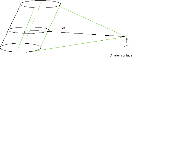

Does anybody out there know how to find the view factor of a tillted cylinder-shaped poolfire?

the shape of the absorbing area is a very small rectangle. the emmiting area is a sheared tilted cylinder.but it retains its circular shape.say the absorbing area is a person, the view factor needed does not include the top and bottom part of the cylinder.only part of the side of the cylinder that can be viewed by the person is taken into account

ok so phi1 and phi 2 give the angles of the two lines from the target to the cylinder which are tangent to the cylinder.they are the angles of the edges of the visible part of the cylinder.
phi1=3.3386
phi2=6.1454
zmin=0
zmax=19.2
diameter of cylinder,D=10m
visible area=integration integration(D/(2cos(theta))SQRT(cos^2(theta)-(cos^2(theta)cos^2(phi))+cos^2(phi))dphi dz
the target is a person standing at at a distance of 46.78m away from the surface of the cylinder.

isabella said:
this is the diagram of the cylinder and the smaller surface
Is the problem looking for what a person sees - or does the problem ask for the total heat radiated to the person? There is a big difference.
The problem is complicated by the tilting. One then has to include the angle of tilt in order to generate a general (non-specific) solution.
Also if any part of the person 'sees' the top, then that is another view factor to consider.
Let me see if I can find some discussion of tilted cylinders.
The problem is about how much radiation is received by the person. It is assumed that the amount of heat received by the person only comes from the area that is visible to that person. It is also assumed that the person is not able to see the top part of the cylinder. I have the area visible to that person. the equation is
Area=integration(lim phi1 to phi2)integration(lim zmin to zmax)|V1xV2|dzd(phi)
|V1xV2|=(D/2cos(theta))*(SQRT(cos^2(theta)-cos^2(theta)*cos^2(phi)+cos^2)(phi))
phi1 and phi2 are the angles that determines the visible area(phi1 is the smaller angle, phi2 is the larger angle)
zmin=0
zmax=max. length of the cylinder.
theta=tilt angle
D=diameter of the cylinder
OK, I think I see what you are doing.
To simplify the problem, one can approximate the person as a rectangle of some height, h, and some width, w.
Then one has to determine the solid angle that the person (h x w) represents to each dA of the cylinder.
In addition to the viewing angles described above, one had the geometrical angle of the slant of the cylinder.
Basically because this is a double area integral, one will have 4 integration limits.
