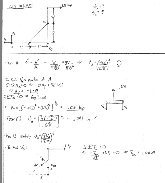

So I got the diameter of the pin at a no problem. For some reason I am screwing up the Force at B. I thought my reasoning was correct, but I am coming up short. The answer is larger then what I an getting, so my F_BC must be too small, thus I am not accounting for something.
Here is my work:
Did you notice if you took moment at the joint where the 1.5 k force is applied in your last FBD, the force BC will have to be 0?
Only now that you mention it. I don't understand. I see that by sum of moments, BC is indeed a zero-force member. But by sum of the forces, I cannot see how it could be.
Where did I err in my Sum of Forces rationale?

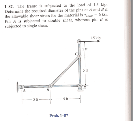

But I am also confused when I now look at the original picture in the text. Is ADC all ONE piece? Or is AD a member that is pinned at D to the vertical piece? If it is all one piece, I can see how BC is zero, but if the horizontal AD and the vertical D to the end (where 1.5 is applied) are two separate pieces pinned at D, then I cannot see it.
This is not a truss, this is a frame. Members in frames have 2 or more forces acting on them instead of just 2 like in trusses. To find the force along BC you could isolate member AD and take moment about D.
I've not seen the symbol used as a pin in this diagram before, but it looks to me like is not one piece.
BC cannot be a zero force member, else it all folds up like a card table. So, if you do sum of moments about D, what do you get for the horizontal component of BC? The horizontal and vertical pieces are single pieces, i.e., there are only 3 members in this problem.
Okay, yes I don't know why I said it was zero sonce there is a perendicular distance from C to the 1.5 force.
If I take the moment about D, I get that BC=2.97, which works like a charm. Thanks.
Can someone tell me though, why did my sum of the forces approach, fail? It really shouldn't?
If I make a horizontal cut through BC and CD like I did in the last FBD I drew and analyze the top half, I should get,
[tex]\sum F_x=0\Rightarrow -\frac{5\sqrt{5}}{5}F_{BC}+1.5=0\Rightarrow F_{BC}=2.12[/tex]
What happened?

The reason the sum of forces "failed" if that for static equilibrium in 3 forces members, the forces if they are not parallel then they (the 3 forces) must be concurrent, but as you can see in the geometry on the FBD you used the forces were not concurrent or parallel therefore one of them had to be zero in order to maintain the sum of moments condition of equilibrium.
Saladsamurai said:
Thanks for your help by the way! I know it's annoying, but I feel like if I can figure out exactly why some methods don't work as opposed to just using the ones that do work, I will have a deeper understanding of the methods of analysis.
Btw, I'm happy you feel this way. What i was saying earlier that if we look closer at the "failed" FBD you will see there cannot be static equilibrium for the reasons already stated. Now i want you to remember again that in frames there can be more than 2 forces acting on a single member. What this means is that generally the forces wouldn't be directed along the members in which they act; their direction is unknown. This is not the case for trusses (i've the feeling you are familiar with them), so in the future for solving problems with frames consider the method described in your book, or the isolating each simple member and applying Newton's 3rd Law.
