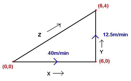

Hi,
I'm designing a C++ program to simulate the operation of a steel processing warehouse. Part of my code requires me to calculate the time it takes for a crane to move certain distances (mainly diagonal ones) across a large shelving rack.
The crane moves at different speeds in different directions.
Maximum x speed = 40m/min
Maximum y speed = 12.5m/min
I was thinking of using pythagoras theorem somehow to solves this (although its not required to be done this way) so:
c2 = a2 +b2
I was thinking of using:
time = distance/speed
to calculate the time for each movement in x direction and y direction. Then using pythagoras theorem on the times to get the diagonal movement time. So an example would be:
X-Time = 6/40 = 0.15min
Y-Time = 4/12.5 = 0.32min
Z-Time = SQRT(0.152+0.322) = 0.353min
Would that be correct? I am not sure if i can apply pythagoras theorem to time like that. Any Help is appreciated
Thanks

I would use Pythagorean theorem on the velocity and distance. Then use t = d/v. You would find how far the crane moves along the diagonal, and if the x-y speeds are constant, how fast it is moving along the diagonal so you could calculate the time.
Thank you for the reply Apphysicist :)
Ahh right, i see. Tried out your method and got the following:
ZDistance = SQRT(42 + 62) = 7.211
ZSpeed = SQRT(402 + 12.52) = 41.907
t=d/v = 7.211/41.907 = 0.17min
That seems a bit quick doesn't it? given that the previous results were:
X-Time = 0.15min
Y-Time = 0.32min
i would have thought the pythagoras time would be closer to the slowest time. No?
