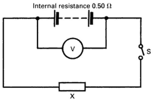

A battery of internal resistance 0.50 Ω is connected (as shown below) through a switch S to a resistor X, which is initially at 0 °C. When S is closed, the voltmeter reading falls immediated from 12.0 V to 10.0 V. The reading then rises gradually to a steady value of 10.5 V.
(a) Explain these observations.
(b) Calculate: (i) the initial current when S is closed; (ii) the initial resistance of X; (iii) the resistance of X when he steady state has been reached.
Answers: (b) (i) 4.0 A, (ii) 2.5 Ω, (iii) 3.5 Ω.

Hi,
Starting with (b) is sensible thing to do. Your 24 A disregards the resistance X. You are supposed to compare the 12 V, 0 A case with the 10 V case when current flows. Where does the 2 V voltage drop occur ?

moenste said:
(b) (i) I tried to find the current via I = V / R = 12 / 0.5 = 24 A, but the answer is wrong.
The 0.50##\Omega## resistor and the load X are connected in series when the switch is closed. Is there really 12V across the 0.50##\Omega## resistor? Keep in mind that the battery puts out a maximum of 12V when it is not supplying a current and that the terminal voltage (which is measured after the 0.50##\Omega## resistor, hint hint) drops to 10V when it is supplying the unknown current.

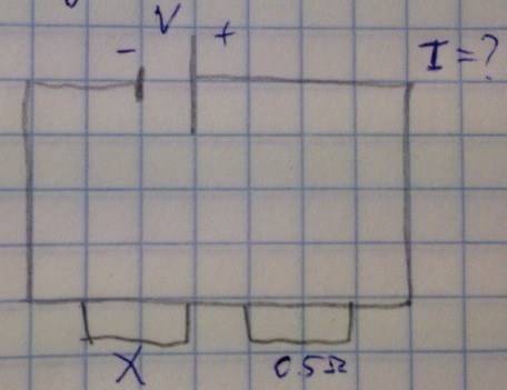

BvU said:
Would it be easier for you if you represented the http://www.designcabana.com/knowledge/electrical/basics/sources/ source as an ideal voltage source with an internal resistance in series ?
Like this?
Yes. Better draw the 12 V as an ideal voltage source now (see link) and the 0.5 ##\Omega## closer to that voltage source. Note that the voltmeter measures the voltage over X, not over the X + 0.5 ##\Omega## (because that is still ... V )

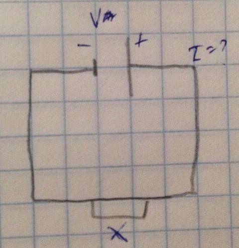

Isn't it the ideal voltage source? The internal resistance is included in the battery.
I thought the voltmeter measured voltage over 0.5 Ω and therefore it has 12 or 10 or 10.5 V since they are in parallel.
Read the link (at "To show non ideality of a voltage source, they add a series resistor to its output, ...") !
The voltmeter measures the voltage at the clamps of the non-ideal voltage source (= 12 V battery) so: what comes out of the dashed box. Namely the 12 V minus the voltage drop over Rs, the internal resistance.

No. We just replace the battery (which is non-ideal voltage source with internal resistance -- as given in your exercise)
by an ideal voltage source with an internal resistance Rs

What is the voltage drop over the ##0.5\ \Omega## when there is no current flowing ?

That would be the short-circuit current. Not 24 V, but 24 A. What you would get if the clamps of the battery were connected directly with one another (##X=0\ \Omega\ ##).
moenste said:
If we do 12 - 10 = 2 V. Then I = V / R = 2 / 0.5 = 4 A. Is this correct?
This is the next step: S is closed and the voltmeter reads 10 V.
So the left end of the ##0.5\ \Omega## sees 12 V and the right end 10 V. The voltage drop is 2 V indeed.

Ah, I see the source of misunderstanding. The exercise composer is more to blame than you.
moenste said:
When S is closed, the voltmeter reading falls immediately from 12.0 V to 10.0 V.
By that he means that the voltmeter reads 10 V 'initially' for the answer to question (b).
(Relatively long) after that, the resistor heats up and the meter gradually goes to 10.5 V

It is, but it reads 10 V. And the battery consists of a series circuit of a 12 V voltage source and an internal resistance.
moenste said:
2. The battery has a voltage of 10 V as well
Yes (10 V) which consists of 12 Volt Vs minus a voltage drop over the internal resistance.
moenste said:
3. I = V / R = 12 / 0.5 = 24 A.
No. the 12 V is distributed over the series circuit consisting of Rs and X.
And we know the voltage over X (namely 10 V, given)

So how much current is needed to make this output level 10 V ?
moenste said:
Hm, what you suggest I should read the problem this way: we have a battery of 12 V, after the circuit is turned on the voltmeter shows 10 V? So it's only the voltmeter that changes and the power source remains the same? And then we just calculate E = Ir + V → 12 = 0.5 I + 10 → 2 = 0.5 I → I = 4 A?
I think this should be it for (b) (i)?
(b) (ii) is clear to me.
However, how to find (b) (iii)? As I understand we'll need a new current? 10.5 = I (X + 0.5). Or like 12-10.5 = 0.4 X so X = 3.75 Ohm.
That's it for b(i).
b(ii) gives what resistance ?
In b(iii) you go off the rails, I'm afraid. The 10.5 V is over resistance X, NOT over the series circuit of X + 0.5 Ω !
Where on Earth would that 0.4 come from ?
  • #31
moenste said:
(b) (ii) E = I (r + R) → 12 = 4 (from the answer) * (0.5 + R) → R = 2.5 Ω.
So the resistor X has a voltage of 10.5 V?
  • #32
The source gives off 12 V, after the internal resistor there is 10.5 V left over. What does that mean for the voltage drop over that internal resistor ? So what is the current throught the series circiut of internal resistor and X ? THe voltage over X is given, so what is the resistance X ?
Likes moenste
  • #33
We have a voltage battery 12 V. We have a resistor -2 V. We have a voltmeter 10 V. We have a resistor X 0.5 V and current I = 0.4 A. So R = V / I = 0.5 / 0.4 = 1.25 Ohm.
12 - 10.5 = 0.5 I
I = 3 A new current in the parallel circuit?
  • #34
You confuse me. The X resistor sees 10 V. That's what the meter indicates. How can it possibly be 0.5 V !? Where does the 0.4 A come from ?
Likes moenste
  • #35
So the VX = 10 V. And internal resistance of the battery is 0.5 Ohm. How do we find the RX?
(i) 12 - 10 = 0.5 I → I = 4 A.
(ii) 12 = 4 (0.5 + R) → R = 2.5 Ω
(iii) 10.5 = 4 (0.5 + R) → R = 2.1 Ω
or 12 - 10.5 = 0.5 I → I = 3 A
10.5 = 3 (0.5 + R) → R = 3 Ω
12 = 3 (0.5 + R) → R = 3.5 Ω
