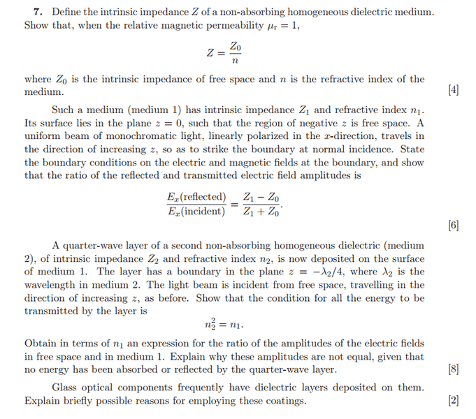

Part(a): Show relation between impedance of dielectric and impedance of material:
Part (b): Show the ratio between reflected and incident amplitude is:
Part (c): Three layers now from left: vacuum, dielectric 2 sandwiched inbetween, and dielectric 1.
Part (d): Give reasons why dielectric coatings are painted on glass transmission devices.
Part(c)
[tex] Z_{in} = \frac {E_{(-l)}}{I_{(-l)}} = \frac {E_i e^{jkl} + E_r e^{-jkl} } {E_i e^{jkl} - E_r e^{-jkl} - E_r e^{-jkl} }Z = \frac { (Z_1 + Z_2)e^{jkl} + (Z_1 - Z_2)e^{-jkl} } {(Z_L + Z) e^{jkl} - (Z_L - Z)e^{-jkl} } Z_2 [/tex]
[tex] Z_{in} = \frac {Z_2^2}{Z_1} [/tex]
[tex] n_2^2 = n_1 [/tex]
To calculate ratio:
Consider boundary at z=0 between Z2 and Z1:
[tex]\frac{E_T}{E_I} = \frac {2Z_1}{Z_1 + Z_2} = \frac {2\sqrt{n_1}}{\sqrt{n_1} + n} [/tex]
Consider Boundary at z = -λ/4 between Z0 and Z2:
[tex]\frac{E_T}{E_I} = \frac {2Z_2}{Z_0 + Z_2} = \frac {2}{\sqrt{n} + 1} [/tex]
Then they are the same! Which is strange because there should be a standing wave in the sandwiched layer, which destructively interferes to poduce a smaller transmitted wave onto boundary z>0..
Part(d)
For impedance matching, so that maximum power is transmitted; no reflection.
