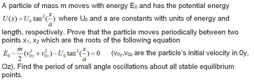

The question is:
A particle of mass m moves with energy E0 and has the potential energy Ụ(x)=U0tan^2(x/a) where U0 and a are constants with units of energy and length, respectively. Prove that the particle moves periodically between two points x1, x2 which are the roots of the following equation E-m/2(v0y^2+v0z^2)-U0tan^2(x/a)=0 (v0y,v0z are the particle’s initial velocity in 0y, Oz). Find the period of small angle oscillations about all stable equilibrium points.
I couldn't prove the first one but i tried to find the period
F = -dU / dx
= - d( U0tan^2( x / a ) ) / dx
= - U0 ( ( 2 sec^2( x / a ) tan( x / a ) / a )
with F=d^2x/dt^2, tan(x/a)=x/a we have
d^2x/dt^2 + U0 ( ( 2 sec^2( x / a ) ( x / a^2 ) =0
from there i don't know how to handle the sec^2(x/a)
Have you seen the general idea of using a Taylor series expansion of the potential function for small oscillations?
Likes PhDeezNutz
PS For the first part, you could think about the fact that the particle cannot keep moving in the x-direction, so it must reach a turning point where ##\frac{dx}{dt} = 0##.
Likes PhDeezNutz
