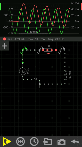

Hello, I've recently been learning about capacitance and inductance causing the current to lead or lag. But how can the current possibly maintain the same waveform? Shouldn't the zeros of voltage and current always align? How can there be current without voltage?

I understand how the power in the circuit is 0 at any time the voltage or current is 0. But I'm not too interested in the power for this specific question.
Perhaps it would be easier (for me at least) to think in terms of the movement of electrons.

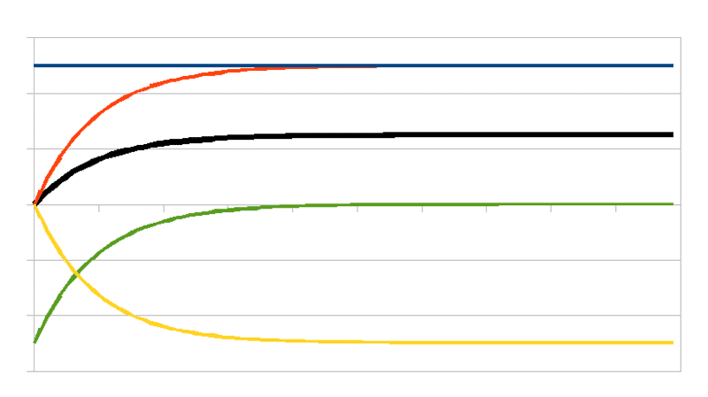

I'm glad you sent me to that article actually, as it shows exactly the graph I'm having trouble with where the current is shifted 90 degrees.
Have I been taught an untruth at some point? Can there be current without voltage?

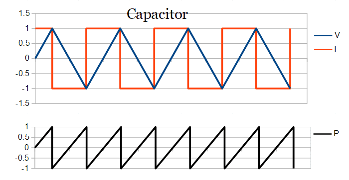

Anorlunda hit it. Check his article..
Remember you're being taught about sinewaves.
Go back to capacitor basics
i = c dv/dt
only for sinewaves do the function and its derivative have the same shape.
d(sine) = cosine , and a cosine is just a sine shifted by 90 degrees.
When one is at zero the other is at peak.

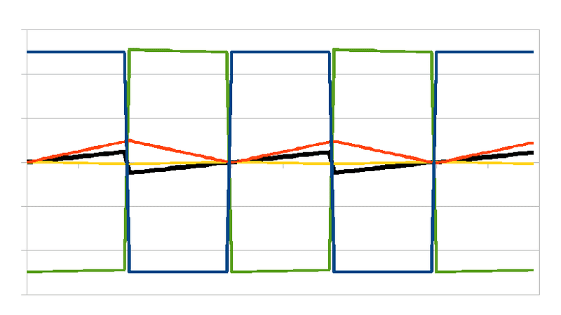

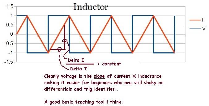

Try it for a triangle wave.

When input voltage is zero, the current in the circuit is maintained by the energy stored in the inductor or capacitor. The phase difference is a result of the energy storing ability of the reactive elements and their V-I relationship.

Because current through a capacitor is not proportion to voltage. It's in proportion to rate of change of voltage.

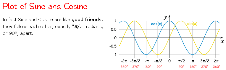

It only does that for sine waves. They are a special mathematical case. We get so wrapped up in our studies we forget about that.
https://www.mathsisfun.com/algebra/trig-sin-cos-tan-graphs.html
Differentiating any other waveform will change its shape.

Take it to DC. Put 100 VDC across a capacitor.
It charges quickly and current drops to zero.
Right there's proof that Zero Current and Zero Voltage needn't coincide.

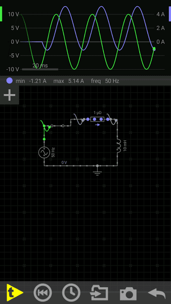

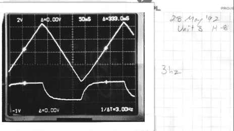

That being said, I haven't looked to see if anyone's observed this on an oscilloscope, so I'll look into that when I have some spare time.

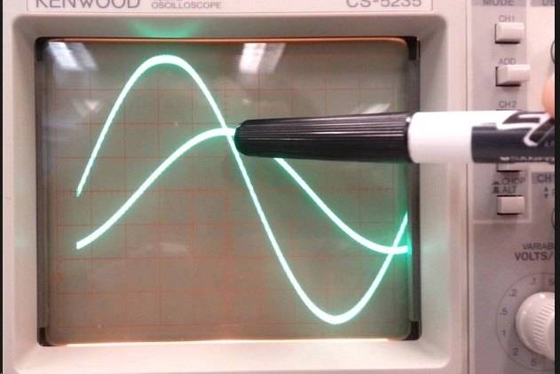

Viewing it on an oscilloscope is one of the first things I did with a scope in school. Trust me, it's there. Why is it you just know that can't happen concerning the voltage being zero and the current not being zero? How do you "just know"? There is no other way to shift phase between current and voltage without having times throughout the cycle where one is positive and the other negative.

And most importantly, seeing it on an oscilloscope!
Thanks for your time and patience with an arrogant greenhorn.

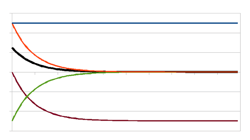

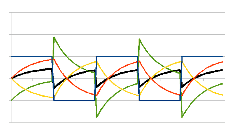

I promised to work an example to explore whether using a square wave rather than a sin wave might make AC circuits easier to explain to beginners. As an old time analog guy, I always learn best from study of time plots. :wink:
Before showing the results, my conclusion is that the answer to the square wave experiment is "No.. Not useful." A square wave allows one to dodge the fuzzy idea of phase angle, but the spiky plots are just too hard to follow.

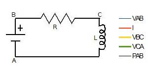

I made a numerical example using an RL circuit. Below is the circuit. Note that I labeled the nodes A B and C. On the right is the color legend for the time plots below. Do not get confused by the sign conventions. VAB+VBC+VCA=0 using these sign conventions.
First, below is a familiar DC step response. Time is the horizontal axis. Initial conditions were all zero. At time t=0+, the current is zero and all the voltage drop is across the inductor. In the steady state the voltage across the inductor, VCA, is zero. The ratio R/L is 10.

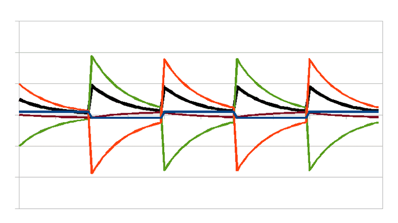

Now below see the same circuit's response to 2.5 cycles of a square wave in VAB. It approximates AC but not exactly because there are not enough cycles shown to wipe out the arbitrary initial conditions. The power PAB can be seen to be both positive and negative during a single cycle. We also see that the times of current zeroes and voltage zeroes are not the same. That was the misunderstanding of the OP in this thread.
If the time integral of power flow over a whole cycle is exactly zero, we say that the AC power is purely imaginary. (@sophiecentaur, the word imaginary comes from the complex number descriptions of this circuit. Blame the history of mathematics, not the history of EE for the word choice.)
I like to stress that P=VI instantaneously always works for both DC and AC. The only time when AC is different from DC is when we define AC values as averages over a whole cycle (and many cycles after the startup transients have died away.) IMO, if we stressed that more emphatically, then students would have less difficulty in going from DC to AC learning.
Finally, see below the same 2.5 cycles, but changing the values of R and L so that R/L is 0.1 instead of 10.0. With those numbers, the voltage across the inductor approximates the same square wave as VAB but shifted one half cycle. Current maximums are roughly 90 degrees out of phase with the square wave. Current wave shape looks like a triangle wave and power looks like a sawtooth.
p.s. I also did the case with a capacitor instead of an inductor, but I didn't upload them because I think the whole exersize (while fun) is of no value. If someone disagrees and asks, I'll post those too.

Triangle wave current through an inductor gives square wave voltage because e = L di/dt
from my old reactor days ( i use this image a lot)
top trace 20 ma p-p current through primary of my rod position indicator coil stack
bottom trace is voltage induced in its secondary
rounded edges are from eddy currents in the nonlaminated steel core
and my function generator current wasn't very linear either
but you get the idea.
to me that's a lot clearer demonstration of the differential relationships than just looking at phase shift of two sine shaped waves.
Students can graphically determine L from di/dt.

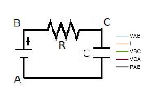

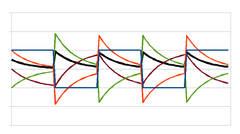

I made a numerical example using an RC circuit. Below is the circuit. Note that I labeled the nodes A B and C. On the right is the color legend for the time plots below. Do not get confused by the sign conventions. VAB+VBC+VCA=0 using these sign conventions.
First, below is a familiar DC step response. Time is the horizontal axis. Initial conditions were all zero. At time t=0+, the voltage on C is zero and all the voltage drop is across the resistor. In the steady state the voltage across the capacitor, VCA, is -VAB, and current is zero The ratio R/C is 10.
Finally, we rerun the 2.5 cycles case but changing R and C such that R/C=0.1 instead of 10.0. Note that the capacitor voltage VCA (the purple line) is a triangle wave as @jim hardy predicted.
In both the inductive and capacitive cases, if I pushed the frequency high enough, the time responses to a square wave would begin to resemble responses to a sin wave. That is why I say that we can do AC analysis no matter what the wave shape. They differ only in magnitudes, not in principles or in forms of the equations.

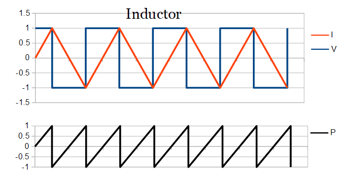

I see now the wisdom of @jim hardy 's square/triangle wave point. Thank you Jim. So I simplified my example and redid it considering one component at a time.
For a capacitor, ##I=C\frac{dV}{dt}##. So a square wave current produces a triangle wave voltage. Voltage max/min occur at the times of current zeroes. Instantaneous power is P=VI. Power is + half of each cycle and - the other half. The average power over an entire cycle is zero. Average V and average I are also zero.
For an inductor, ##V=L\frac{dI}{dt}##. Everything we said about a capacitor applies here if we just reverse V and I. P remains unchanged.
For a resistor, ##V=IR##. A square wave voltage results in a square wave current. Voltage and current zeroes happen at the same times. Power is positive the whole cycle, so the average power = instantaneous power = VI. When V is +, I is + so P is +. When V is - I is - and P remains +. So average V and average I are zero, but average P is plus.
So there we have the essential components and definitions for AC circuit analysis, without using sin/cos and without mentioning phase angle. Does anyone think it would be easier to introduce AC if this example were intermediate?
Likes Asymptotic, cnh1995 and jim hardy
No, I thank YOU !
Your new sketches are SOO much easier to see.
Kids who've not yet had any calculus at all can work it graphically with just algebra .
