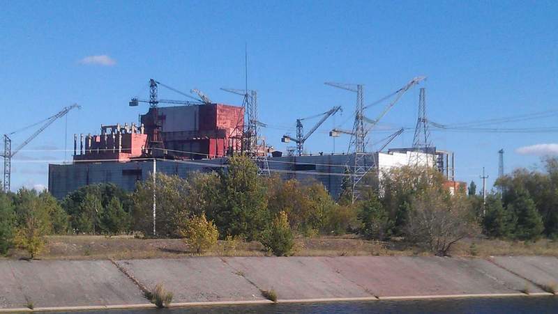

That's an awesome picture btw, here's one of the scrapped reactors 5 and 6 I took whilst I was there, complete with cranes and half-finished buildings where construction was suddenly halted. Spooky!

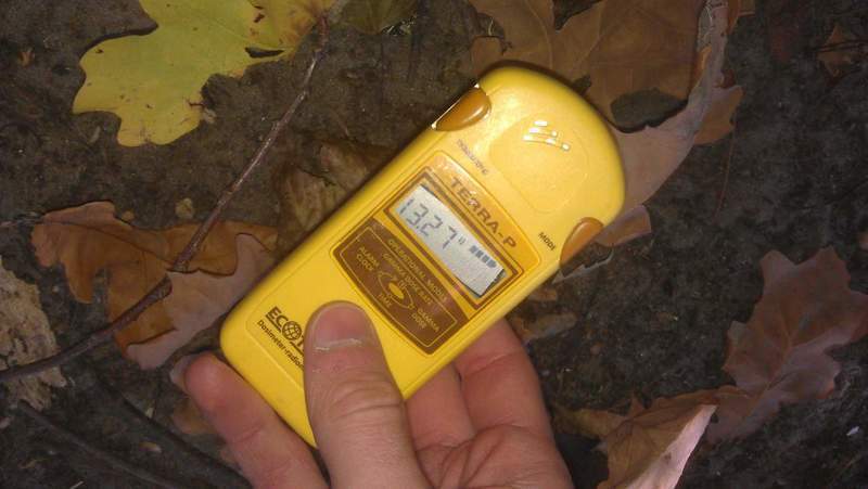

The only place in Chernobyl that has DANGEROUS levels of radiation is inside the reactor block itself.
I posted a picture above that showed a gamma dose rate on a soil hotspot of 13.27 μSv/hr. The nuclear industry considers this a 'dangerous level'. Whilst much of the exclusion zone is low in dose rate, these hotspots are what make the area unsafe (from a radiological point of view, there are other dangers).

Shisnu
Sometimes, when a strong wind they spin and it seems that the work continues.
If it were not severe pollution (especially actinides) mechanisms to be dismantled Metal scrap.

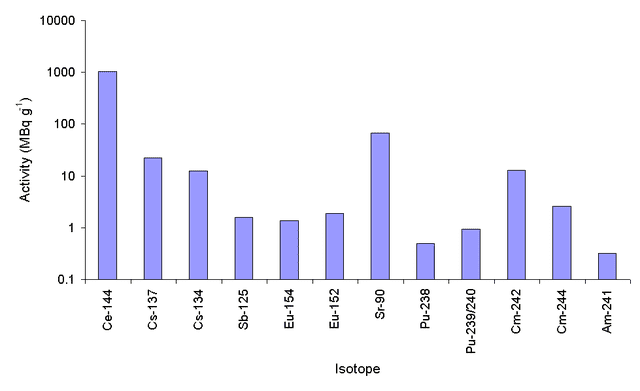

During the first few years after the disaster radioactivity, and accompanied dangers to workers' health, is decreasing noticeably.
For example, initially Cs-134 constitutes about half of radioactive Cs inventory (the other half is Cs-137), but its half-life is only 2 years. It makes sense to wait for it to decay. In 10 years, it will decay to 1/64 of initial level.
After ~10 years, waiting more stops making sense.
It's not just Cs-134. See attached file. After 10 years, radioactivity decrease of fission products has a plato. While weathering of ruins doesn't.

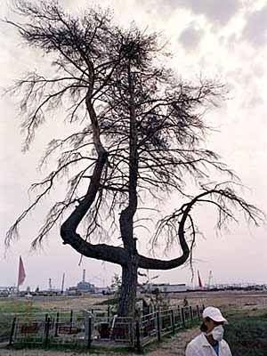

Sorry, I tried searching but for some reason I can't find it now.
But here's this picture of a mutant tree just outside of the reactor.
chernobyl-dying-tree-germans-used-to-hang-partisans-from-its-branches.jpe

No, it isn't a mutated tree. The tree is even older than Chernobyl NPP.
Oh, I thought that tree grew around high levels of radiation and thus was deformed.
Aren't the trees in the "red forest" outside of Chernobyl highly irradiated and malformed, and the trees turned red after the disaster?
nikkkom
In 10 years, it will decay to 1/64 of initial level. After ~10 years, waiting more stops making sense. It's not just Cs-134.
