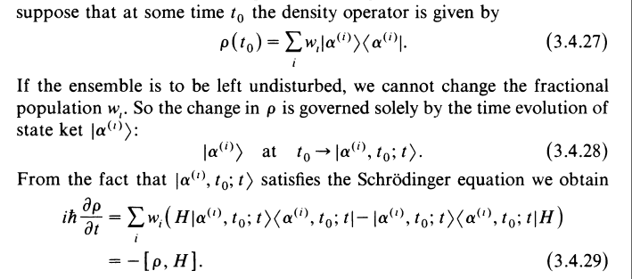

Yeah, I kept coming to that conclusion too yet what I wrote is what is in Sakurai's book..
i\ \hbar \partial_t \rho = H \rho \neq -[\rho , H]
Where \rho = \sum_n w_n |a_n \rangle \langle a_n |
I'll attatch an extract
OK, the point there is that \rho does not satisfy Schrodinger's equation so i\ \hbar \partial_t \rho \neq H \rho. Instead you have to use
i \hbar \frac{\partial}{\partial t} |\alpha^{(i)},t_0;t \rangle \langle \alpha^{(i)},t_0;t | = \left( i \hbar \frac{\partial}{\partial t} |\alpha^{(i)},t_0;t \rangle \right) \langle \alpha^{(i)},t_0;t | + |\alpha^{(i)},t_0;t \rangle \left( i \hbar \frac{\partial}{\partial t} \langle \alpha^{(i)},t_0;t | \right)
and
i \hbar \frac{\partial}{\partial t} \langle \alpha^{(i)},t_0;t | = - \left( i \hbar \frac{\partial}{\partial t} |\alpha^{(i)},t_0;t \rangle \right)^\dagger .
The derivation I gave above is valid for time-independent states and wouldn't work here.
