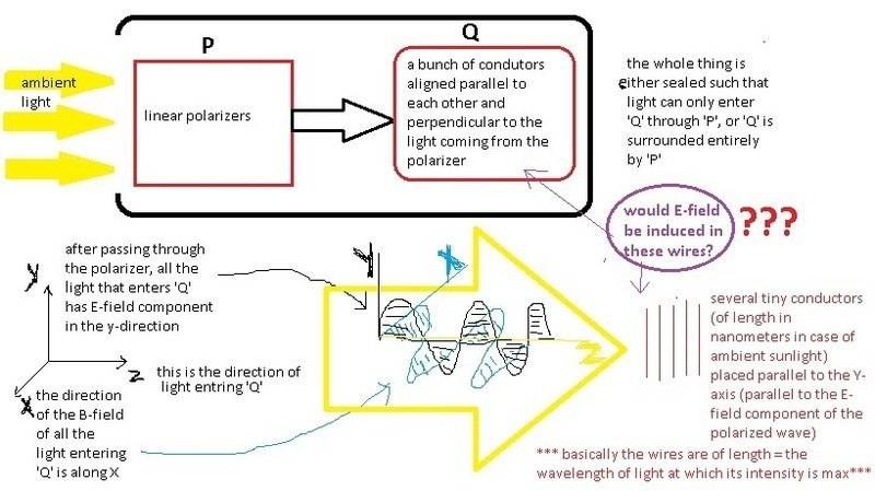

one question is in the diagram itself and there is another one based on that here :- would this induced E-field (in the wires) be equal or related to the E-field component of the incident light as per the diagram?
sorry for the crude drawing
