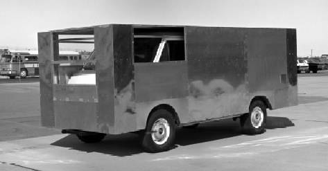

RonL said:
Reducing friction drag on the skin of the vehicle will be the biggest area of innovation. We might start with something as non-se*y as a bus and work down.
You're not an ex-NASA scientist are you?
from page 28 of the http://www.tercelreference.com/downloads/gettrdoc.pdf" I mentioned yesterday:
The test vehicle that NASA used is shown below:
Figure 7. NASA Dryden Research Vehicle – Box Shape​
NASA’s interest was primarily directed at improving semi trailer
performance but these results are even more appropriate for light trucks. They
found that a practical drag coefficient (Cd) of .25 was possible when a rounded
front was implemented along with a truncated “boattail” shaped back.
I was all like; "That's a NASA designed vehicle?" on Sunday. But seeing your bus comment today made me realize that science isn't always pretty, nor as sophie.c pointed out, intuitively logical.

LOL, Om I thought you had read more of my posts, I can't even get much attention in the overunity crowds.
I didn't have time to go further when I made the post, but my thinking was to have the front like they said, but with suction intake in the center, then round the back into a taper circle and have two counter rotating, 7' diameter Tesla style turbines exhausting in the center.
Have you ever driven a few car links behind a trailer rig and felt the rough air gusts that are shed? If you move up too close, you ride in the draft area and it is pretty smooth.
No I did not know of their test design, but it makes me feel better about my thinking.:cool:
Sooo much room for design work.
