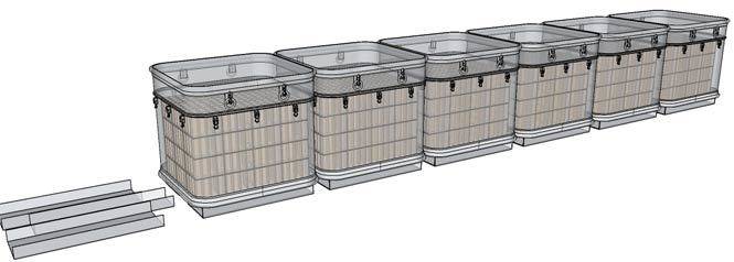

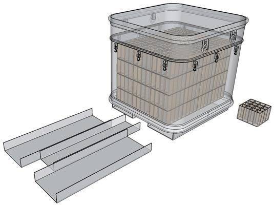

We just bought 22 aluminum shipping containers at a government auction to make a variation of the Earth tube. The containers hold about 1 cubic yard of material each and have sleeves underneath them so that a forklift can pick them up. Since the entire container is aluminum the heat transfer properties are excellent. I've attached a couple pictures of what I am talking about.
Simple inserts will be used to bridge the gaps between the containers (kind of like gutter downspouts that are fitted into each other). Air will pass down one side, back up the middle, and down the opposite side and exit the system. that way we get 3 times the distance for each run.
The containers will hold water and recycled clay bricks that used to be used in a cooling tower. They are 9x9x6 inches each and will allow vertical travel of the water through the stack.
As the ducting under the container starts to warm up that heat will be transferred through the aluminum into the ground and into the water above the pallet fork sleeves. Warm water will rise away from the ducting and cooler water will settle. The bricks add additional mass to our "therml" battery.
Since our humidity is usually 80-100% and our dew point during the summer is 70F, I expect a lot of condensation. We plan to use a gravity drain to capture that water. Simple solar pumps and shading techniques will be used to bring the water above ground that will be used in our U-pick section for vegetables. We don't want the pumps running all day so the shading will allow sun to strike the pump panel once or twice a day for a certain period of time. This means you don't have to worry about switches failing or corroding. No batteries are needed because we don't really care about pumping at night or energy storage.
To push air through the system we are using 12v fans like found in RVs or boats. They move a lot of air and don't need much energy so you can get by with a smaller panel. At night we will just use grid power. It will only cost pennies to run the fans.
We are pushing air through the system. This is important because when you push air into a system you create a higher pressure which will cause more condensation to form. If you pull air through the system you still get condensation, but not as much. We want the water for agriculture purposes so we will be pushing it into the system.
The bottom line is that we could have used a gravity trap to drain away the water and had a very simple system (two fans and some solar panels). When you start getting into heat exchangers, etc. you are adding more energy usage and more possible points of failure.
