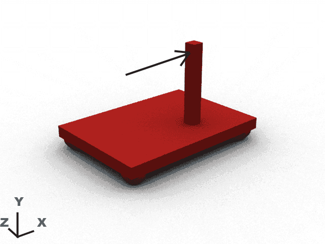

I'm pretty rusty on my statics. I'm wondering how I could determine the reaction at four points arranged in a rectangle, with a force acting in the x direction at a distance away from the plate I have shown in this graphic. I seem to remember the term statically indeterminate, I think this applies, but is there any way to figure out the forces that each of these corners see? (Assume the points are fixed to the floor.)
Thanks in advance.

You're right, it is statically indeterminate … you can calculate the forces for a table on three legs, but not on four legs (basically because if you take one leg away, the table will still stand up … or, mathematically, because you have more unknowns than equations).
Of course, you can solve it, but you need one more equation …
in this case, you need to know how bendy the table is. :wink:

A modulus … see http://en.wikipedia.org/wiki/Modulus_of_elasticity" :smile:
also, are tensors used to solve this problem?
Maybe … bendy-ness depends on lots of things (it's flexible :wink:).
