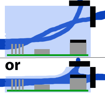

I attached an example image of what I mean. I cannot imagine any scenario where example 1 is better than example 2.
I am also very familiar with computers. I am a system designer / builder for high load workstations and servers. I use water cooling on most everything as its almost mandatory. Fans are obviously still needed though.
Anyhow, in any case, the less air inside the enclosure should mean the smaller fans you can use. I think that is a detriment to smaller form factor cases that use small fans. As you mentioned before, the more compact cases seem to have higher heat and subsequent hardware failure. However, a large case holds typically 5 fans including the PSU and CPU fan. A smaller ITX case may only have one or 2 fans, and they are much smaller, sometimes down to the size of poker chips.
Also as you mentioned, added fans that give directional flow over hotter components will allow them to run cooler. In that case this would mean the smaller enclosure would benefit more because the flow can be very easily manipulated to be as directionally focused as you want. I think the typical look at small and large form factors is not a good approach to what I'm proposing, since smaller form factors use smaller and less fans. But it really is a simple principle, and always keep in mind the fans in both scenarios are the same size/power/quantity. The smaller the air volume of the case, the faster the fans can cycle new (cooler) air in and out. And the closer the flow is to the components in the system.
Though traditionally smaller form factors have less cooling efficiency, I can guarantee if you attach the same amount of fans from a large workstation onto an itx box and somehow can find a way to fit all of those fans, you would be cycling much more air through the volume of the case at a much higher rate and that air would be very focused on the components. Where it could take 3 seconds (just guessing) to cycle all the airspace in a tower in and out, it would proportionally take about 1 second on a smaller case with 1/3 the airspace. Just keeping in mind the input of air (fans) are the same for both cases. Like in the example image and not some tiny fans like are typically used on smaller cases.

I must still disagree with your basic premise.
The reason you need extra internal fans, heat pipes, water cooling etc is to remove heat from the hotspots (as you yourself said).
I have participated in another forum a series of experiments to determine which way round the cpu fan should be mounted for coolest cpu temperatures. This fan is distributive rather than exhaustive. Since it plays into the throughflow airstream its action contributes greatly to the airflow resistance.
Internal resistance to airflow is the really big point that you are not addressing. It encapsulates the old engineering compromise between distribution and concentration, you will find that in everything from a planetary system to cities to powerstations, to factories to vehicle engines to nano engineering the issue is the same. The difficulty of cooling a concentrated heat source exceeds that of the dificulty of cooling a distributed one.

Your comparison is not exactly what your question is. Your comparison is a bit of an extreme where you assume the flow is channeled away from the components, which at the most extreme turns your forced convection cooling into natural convection. Your question, as stated, is simply about reducing volume.
You're on a good track, you just need to figure out what your real question should be and work on a few of those assumptions.
I think the main problem is actually the fan input to airspace ratio. Meaning when the airspace drops inside the case, the pressure increases and causes drag on the fans. So if we take the same amount of fans from a large tower on a small case, the fans will actually turn slower because the pressure difference on both sides of the fan in the smaller case, so we would not be seeing the same cfm from the same fan in both cases.

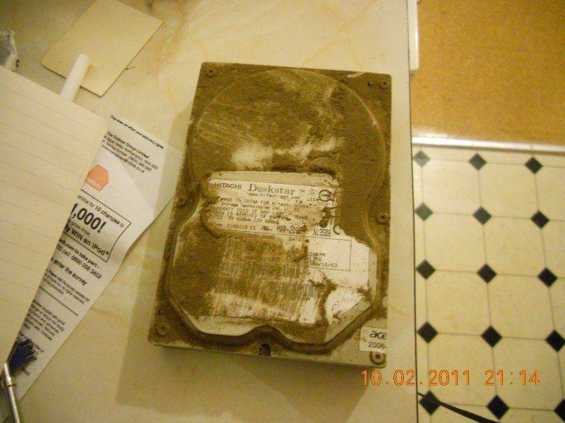

Attached is a photo of a component after 3.5 years service inside a pc tower, that I took out today. I have cleaned a bit so you can see what it is.
This is why I think there are more important considerations than airflow, although, of course, airflow remains important.

Wow and I thought mine were dusty.

Jesus Lord! lol. I don't think I have ever seen one that bad. Of course most things I handle are in "clean" environments like data centers, but dust can still build up, but never like that.
I guess We could say some kind of filtration would be needed on the case but then we are back to the limitation of the fans, pressure, drag etc. Probably making it much worse as far as air flow.
Unfortunately I didn't think until after cleaning the inside of the tower about taking pics for this thread so this was the best I could do. Since the HD is inside an internal enclosure it was not as heavily encrusted as the general inside.
Nor is this the worst I have seen by a long shot. But I think the best part was I was asked to replace the HD because it was "getting full and slowing Windows down". Used space 38.7GBytes - free space 8.9MBytes
