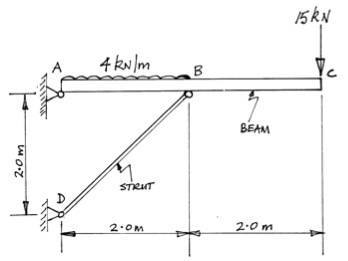

A uniform beam, supported by a uniform strut, is loaded as shown in Figure (Attached). Using the unit load method, determine the value of the vertical deflection at C.
BEAM: E = 205 kN/mm2, I = 90 x 106 mm4.
STRUT: E = 205 kN/mm2, A = 1500 mm2.
The virtual work equation, which is.
1.\Delta=\sump\frac{PL}{AE}+\int\frac{mM}{EI}dx

I then attempted to solve the virtual work equation, however the value of A for member AC is not given.
So i guess my questions are, have I started this correctly, and how do I solve the problem?
I think you must be worrying about the axial shortening of DB, whose A is not given. Even if you know it, and assuming no compression buckling, the shortening of the strut would have a relatively small contribution to make to the deflection at C. You could insert your own practical value of A to assure yourself how small it really is. One might also recognise that AB also has some axial compression, but you don't know that area either. To be pedantic, the hinge at A is off the centreline, so there actually is a small additional moment due to the eccentric axial load there, but I recommend you note this but ignore it. Incidentally I would say Ax= - 11 not + 11. I don't agree your values of Bx and Ax. Have you checked your figure for equilibrium with the reaction components you have calculated, for example by taking moments about C? Have you drawn a force diagram to scale for all the external forces on this structure? That is a good way to reveal errors. On re-reading the question, I see a value of A is given.

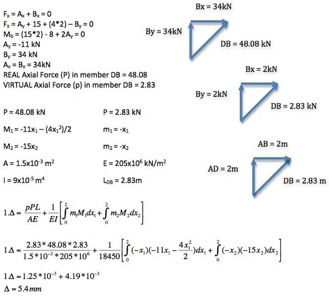

Ok, here's my next attempt
I've done it in word, as the workings are easier, and attached a picture.
I really hope the reactions Ax and Bx, and the force in member AD are right now, the triangles should explain how i got the numbers.
As for the virtual work equation,
dx1 works from A to B
dx2 works from C to B
M1 is the real bending moment equation of section AB
m1 is the virtual bending moment equation of section AB
M2 is the real bending moment equation of section CB
m2 is the virtual bending moment equation of section CB
M1 hopefully now incorporates the moment due to the UDL.
Just noticed the second line should be Fy= not Fx=
and Ax = -Bx
I don't agree your result, doing it a different way. For example, PL/AE is the elastic shortening of DB, and I get 0.44 mm. This has a vertical component of 0.44 / sqrt 2 = 0.31 mm. So the deflection at C due to elastic shortening of DB should be 0.62 mm, not 1.25 mm (your figure). I agree your result for bending = 4.19 mm.
