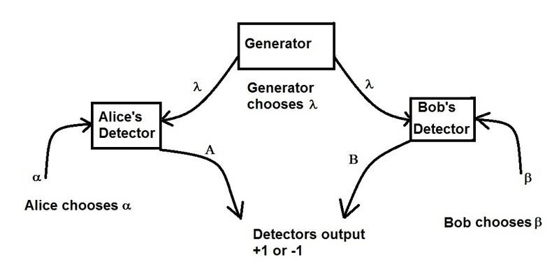

I'm surprised you think that my example looks like a conspiracy. Remember that DrC's challenge was supposed to show that even with conspiracy, it is impossible to violate Bell's inequality. I don't think DrC was asking for a random dataset -- it kinda defeats the purpose; why would he ask for one if anybody could generate one randomly? And if it is assumed that a physical process is producing the data, why can't the physical process have behavioural patterns that are non-random?
  • #115
The result was the same as before: sorry Bill, I got 10 times no violation of the Bell Inequality.
Bill, if you like I can send you the spreadsheet.
I did the calculations for the random sampling case I discussed as "Treatment (3)" in post #92.
For the following dataset,
a, b, c
+1, -1, +1
-1, +1, -1
-1, +1, -1
-1, +1, -1
+1, -1, -1
-1, +1, +1
-1, +1, -1
+1, -1, +1
-1, -1, -1
-1, -1, -1
-1, -1, +1
-1, +1, +1
+1, -1, -1
+1, -1, -1
-1, -1, +1
-1, -1, -1
+1, -1, +1
-1, +1, -1
-1, +1, -1
+1, +1, +1
+1, -1, -1
-1, -1, +1
+1, -1, +1
+1, -1, +1
+1, +1, +1
-1, -1, -1
+1, +1, +1
-1, -1, -1
-1, +1, -1
+1, -1, +1
Here is the method I use. REMEMBER - you must sample without replacement. This is equivalent to randomly shuffling the dataset and then picking the first 10 of the resulting dataset for calculating ab, the next 10 for bc and the last 10 for ac, in a manner similar to treatment (2). Again to be clear, the procedure is as follows
- Randomize the sequence by shuffling it
- select the first 10 of the resulting randomized sequence, and use for the ab term, the next 10 for the bc term and the last 10 for the ac term.
This way, we are sure that every row is used NOT MORE THAN ONCE.
I did the above 10 times, randomizing everytime from the previous random sequence and got the following results:
ab=-0.4000, bc=0.0000, ac=0.4000, Violated=False
ab=-0.4000, bc=0.0000, ac=0.2000, Violated=False
ab=0.0000, bc=-0.2000, ac=0.2000, Violated=False
ab=-0.6000, bc=-0.4000, ac=0.4000, Violated=True
ab=-0.2000, bc=-0.2000, ac=0.6000, Violated=False
ab=-0.2000, bc=-0.8000, ac=0.2000, Violated=True
ab=0.0000, bc=-0.2000, ac=0.4000, Violated=False
ab=0.0000, bc=-0.4000, ac=0.2000, Violated=False
ab=-0.6000, bc=-0.4000, ac=0.0000, Violated=False
ab=-0.4000, bc=0.2000, ac=0.8000, Violated=True
Repeating this 1000, consistently gives me a violation in about 20% of the randomly sampled (without replacement) pairs.
NOTE, 1 violation is enough.

That is incorrect. You are confusing expectation values with averages. Bell's inequality is stated in terms of expectation values and you are getting averages. Expectation value of 100 fair coin tosses is 50 but the average of a particular run can be anywhere between 0 and 100. It does not mean anything.
If you want to do the job properly, then please calculate not only the mean values but also standard deviation. You will then find that Bell's inequality actually holds quite well and the occasional deviations are well within the error bars.
If you can show how to beat Bell's inequalities consistently by at least a few standard deviations (which is the case with QM), then you have the case, otherwise you would have to try harder.

Oh, this paper is much better written than De Raedt and the cheating step is much more subtle. But it is similar.
billschnieder said:
Bell's inequality is equivalent to saying "The sum of any 3 sides of a die will never exceed 15".
No, this is not what Bell says at all. Your example is pure arithmetic and Bell's theorem is statistical. There is a big difference.
Bell basically has a triangle inequality for the expectation values of lengths. He specifically introduces [itex]P(a,b)[/itex] as expectation value in (2)*
This is different from ordinary tirangle inequality for a single triangle. Ordinary triangle inequality is valid only when all three sides belong to the same triangle (obviously). By summing over a sequence of triangles one gets similar inequality for average triangle. But there is a constraint: the same set of triangles must used when calculating averages for each side.
The constraint is removed when one transitiones from sums and averages which vary from one experiment to the next, to expectation values which are a property of the stochastic process as a whole. Doing this requires certain assumptions about the process (eg. stationary). In Bell's paper these assumptions are encoded in the probability density [itex]\rho(\lambda)[/itex] being function of [itex]\lambda[/itex] and nothing else and [itex]A(a,\lambda)[/itex] and [itex]B(b,\lambda)[/itex] being fully deterministic. These extra assumptions about the stochastic process behind the data is what allows one to estimate expectations of each side of the triangle independently.
