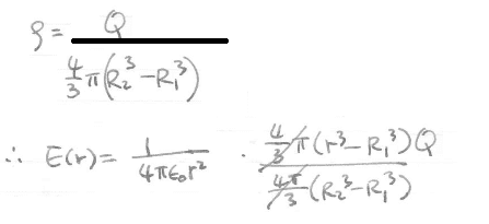

Hey I am currently studying for my final and I am stuck on a question i have the solution but I am not sure what he did, could someone explain
A hollow sphere of the inner radius R1 and outer radius R2 is uniformly charges with total charge Q. Calculate the electruc fiels in the three regions shown in the cross-section view below 1) r<R1, 2) R1 < r <R2, and 3) r >R2
What i don't get is part two, i know he is using gauess law Q inclosed/e = E(r)*A
but i don't know how he got Q and reduced it

What i don't get is part two, … i don't know how he got Q and reduced it
the total charge is Q, so the charge density is Q/volume = Q/{4π/3(R23 - R13)},
so the charge inside radius r is the density times the volume within radius r, ie 4π/3(r3 - R13) :wink:
Thanks for the respond I am getting there but can you explain one thing
I get what your saying but i don't see where the Q overall charge disappeard
This is my logic of the question and the Q which is overall charge remained in the equation
suppose R1 was 0 (ie, a solid sphere) …
then the charge within radius r would be Q(r/R2)3, wouldn't it?
this is similar … the charge is Q times (volume/total-volume) :wink:
