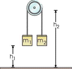

2. the two masses, m1 = 2.10 kg and m2 = 3.20 kg shown in the figure below, are each initially h1 = 1.56 m above the ground, and the massless, frictionless pulley is fixed h2 = 4.84 m above the ground. suppose the pulley is suspended by a cord to the ceiling. what is the tension in this cord after the mass is released and before it hits the ground? (i have attached the figure)
when i try to work this problem, i understand that the masses are both accelerating at the same rate, with m1 going up (y+) and m2 going down (y-) and that while they are in this state, they put a force downward on the pulley, which in turn puts a tension into the rope. i am not sure how to find the tension in that rope that is suspending the pulley from the ceiling.

2. Yes.The heavier weight will go down, pulling the lighter weight upward. The force necessary to do that (the difference between between the weights) is the force the rope is exerting on the pully and, since the pully is not moving, the force the pully is exerting on the rope: that is the tension in the rope.

For the second problem, you can use Newton's second law (F=ma) to find the acceleration of the masses. Since they are connected by a rope, they will have the same acceleration. Once you have the acceleration, you can use the equations of motion (d=vi*t+1/2at^2) to find the time it takes for the masses to hit the ground. Then, using the equation for tension in a rope (T=ma), you can find the tension in the rope before the mass hits the ground.
Remember to keep track of the direction of the forces and accelerations, as they will affect the signs in your calculations. It may also be helpful to draw a free-body diagram for each mass to visualize the forces acting on them. Good luck with your homework!
