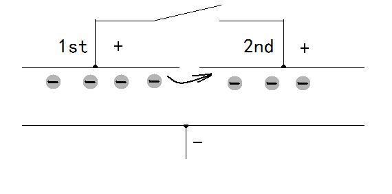

if two equal capacitor one of then is charged and the other is not.then the switch is closed, half of the stored energy of the 1st capacitor will be lost.
if there is a way to move electrons from one of the positive plates to the other positive of the other capacitor,will it require less energy than half energy stored in the beginning ?

as you can see in the attached picture.how can you calculate the energy required to move half the electrons from the 1st positive plate to the 2nd positive plate,if we will assume the distance between the two positive plates is d and the starting voltage on the 1st capacitor is V

energy to move charge Q from the positive plate to the 2nd positive plate = Q*V
but if V is less that he voltage which was applied on the 1st capacitor then the power dissipated will be less than the half.
so what is the potential defrance between the two positive plates ?
the applied voltage on the 2nd plate equals the 1st plate

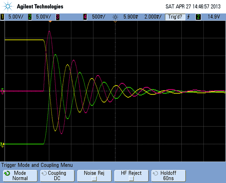

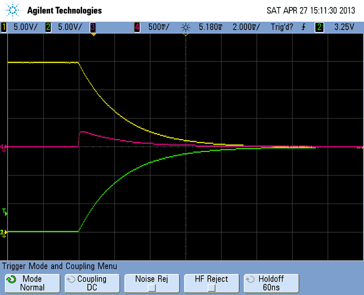

Here's a schematic of a circuit I wired up. The two capacitors are 470 μF each and the inductor is an "air core" 500 μH unit. C1 is initially charged to 30 volts, and C2 is initially uncharged.
When the switch is closed, the capacitors and inductor form a resonant loop and a half cycle "ring" of the circuit begins. The current in the inductor builds up and then decays. When that current reaches zero and attempts to reverse (as it would without the diode), the diode "disconnects" the inductor, and most of the energy has been transferred to C2.

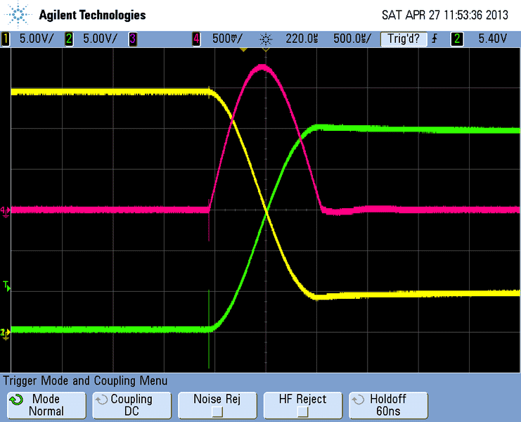

Here's a scope capture of the voltages across C1 and C2, and the inductor current. The voltage across C1 is yellow, across C2 is green, and the inductor current is red. The current was measured with a clamp-on current probe and the scale is 5 amps/cm, reaching a peak of about 17 amps.
C1 starts out at 30 volts and ends up at about 5 volts. C2 starts out at zero volts and ends up at about 25 volts. C2 doesn't charge up to the full 30 volts as it would if everything were lossless, but at 25 volts it contains much more energy than it would if the two capacitors were simply connected with a switch.
So, it is possible to transfer energy from one capacitor to the other without losing a full 50% of the energy.

With no diode the result is:
Note that the ground reference for the two voltage traces (yellow and green) is at the bottom 1 cm; you can see a ground symbol down there at the far left. The final result is 15 volts on both caps.
Here I have inserted a 10 ohm resistor in series. Now we're overdamped.
Still 15 volts on both caps at the end.

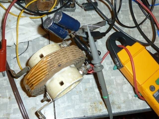

Here's a picture of the experimental setup:

You can see the horizontal sweep speed at the top of the image--500 μs/cm for the first image. Later images are 2 ms/cm. Channel 1 and 2 are 5 V/cm, and the current scale is 5 A/cm.
