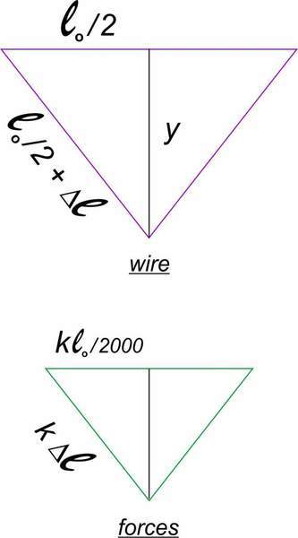

I have two triangles to consider:
one of lengths, with base l0/2, height y and hypotenuse l0 + x
one of Forces, with base Ti, height mg/2 and hypotenuse T = -\frac{AY}{l_0}*x
I've tried a lot of things. I'm missing something fundamental.
If you can get the correct answer, I would appreciate a little direction.
Wire extension
Does this make sense?
At this stage my answer seem to be out by a factor 2.

For forces,
how did you get kl0/2000 for the horizontal aspect?
From the conditions on the vertical orientation of the wire, you get that
YA = 1000 mg

1/2 mg = k lo /1000
Basic_Physics said:
1/2 mg = k lo /1000
This is incorrect. We already showed before that YA=kl0=1000 mg, based on the weight being in equilibrium when the weight is hung from the wire vertically. The question I was asking was, what is the general relation between the tension and strain, to wit:
T = YA (strain) = kl0 (strain)
In the case of the horizontal wire, this gives
T = YA (2 (y/l0)^2)=1000mg (2 (y/l0)^2)
See what you get when you substitute this into the force balance.
Typo, I wanted to say
1/2 mg = k lo /2000
This I concluded from the information given in the initial problem statement.
The 1/2 factor comes from the fact that only half of the magnitude of the weight is used for the base of the inverted right angled triangle in the force diagram. Do you agree with that?
1/2 mg = k lo /2000
No. If this is the force balance for the weight hanging from the horizontal wire, then it is incorrect. From the free body diagram, if T is the tension in the wire, you have to determine the component of T in the vertical direction (see the force balance equation that I gave in my earlier post). Also, the strain and tension in the horizontal wire are not the same as in the vertical wire.

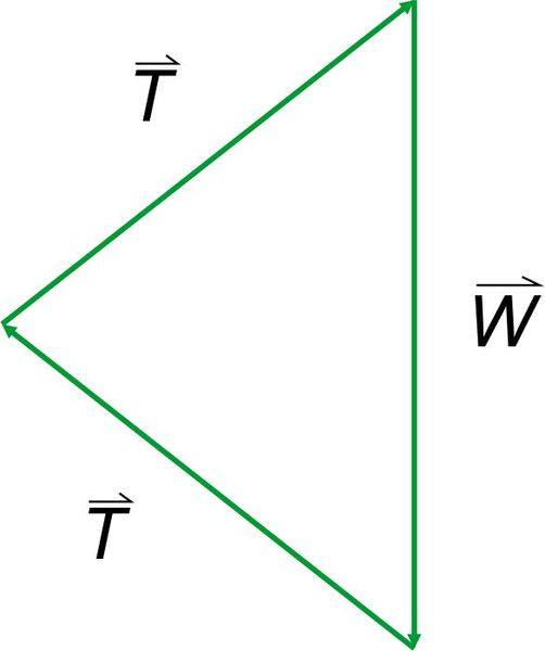

I used a vector diagram for the forces turned through 90o
where W is the weight and T the tensions in the wire.
One can then use the fact that the two triangles are congruent to compare the ratio of the sides.
This diagram is not what is described in the problem statement (for which the book solution and my solution apply). Think of a long horizontal clothesline from which you hang a small weight at the center.
