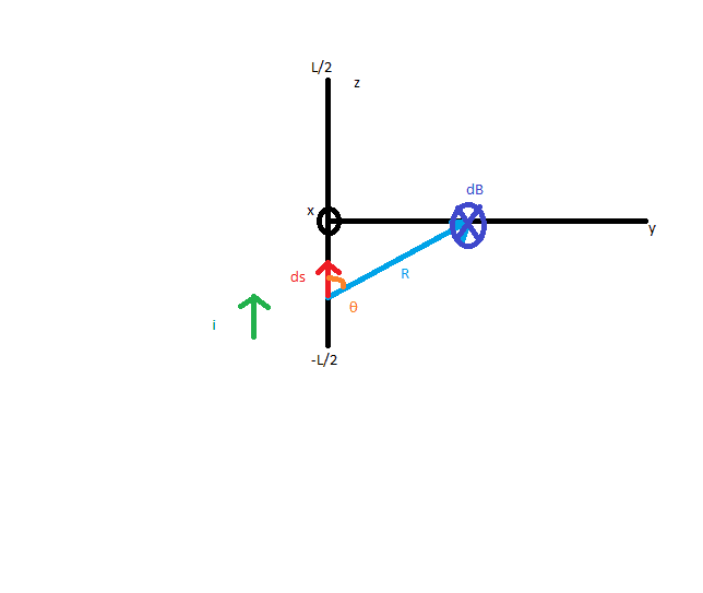

In my E&M class yesterday, in going over an example for the Biot-Savart law, I couldn't quite understand the initial setup of a problem (this may be more of a math question, but given the source, I figured it ought to be posted here). The attached picture is a crude MS Paint reproduction of the graph shown in class (letters are color coded to correspond to the line or figure they represent); I don't have a working scanner at the moment, and even if I did, this is a lot more legible than my handwriting.
Ok, the question:
In the diagram, we defined $$ \vec{ds} , \vec{r}, |r| , and \sin{\theta} $$
ds, r, and sin θ were quite straightforward.
But in defining $$ \vec{r} $$, we used:
$$ \vec{r} = y\hat{y} - z\hat{z} $$ (using y and z as unit vectors instead of j and k)
Given that the vector r points from (y, z) = (0, -z) to (y, 0), I'd have expected it to be defined as:
$$ \vec{r} = y\hat{y} + z\hat{z} $$
As that's how every math class I've taken would have defined it; the calculation appeared to work out (dB pointing into the page) using the definition put on the board, but I can't understand why it was chosen.

The law itself I understood when carrying out the calculation. I simply couldn't why the r-vector used in the equation was defined with a -z instead of a +z.
The contribution from a wire element at (0,-z) will be the same as that from a wire element at (0,+z).
My guess is he's done it for the semi-infinite wire and multiplied by two. The reflective symmetry of the problem along the z=0 plane should mean you get the same answer upon swapping z for -z.
