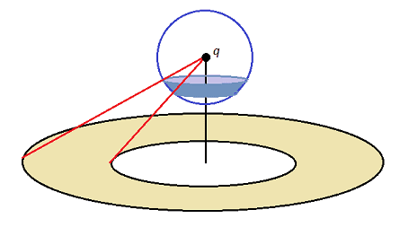

Did you integrate by breaking the annular region of the disk into nested rings and integrating the normal component of E over the rings?
If so, there is a trick you can do to set up a much simpler integral that will yield the result. (You can avoid actually doing this integration if you happen to know the formula for the surface area of a spherical cap (hint). But that's something I would have to look up :blushing:)

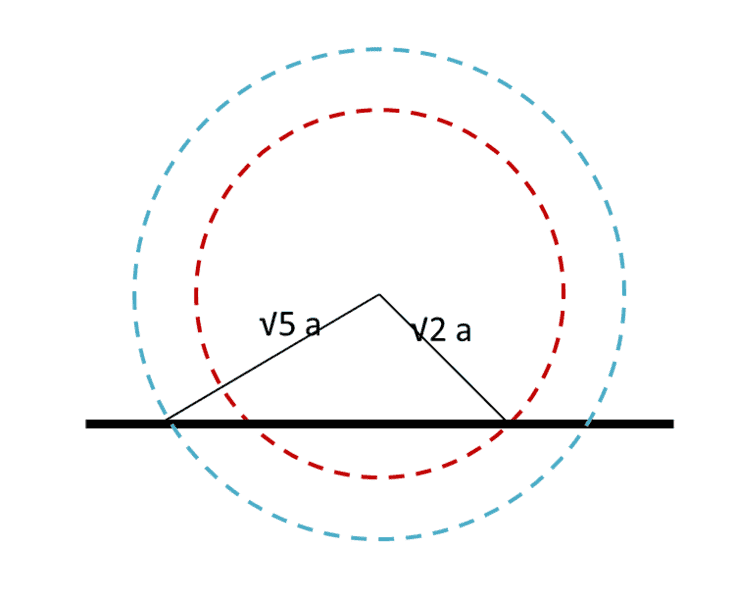

I think I understand your trick but I don't seem to able to apply it. Don't we have two spherical caps here? One of radius ##\sqrt{2a^2}## and the other of ##\sqrt{5a^2}##.
I was thinking of working with a single sphere which you could take to be a sphere of unit radius. But, yes, there will be two spherical caps on this sphere to consider, if you want to avoid integration. Or, you can set up a simple integral on this sphere and not worry about looking up a formula for the area of a spherical cap.

Umm...I don't get it, I have attached a figure, do I have to find the flux through the red spherical cap? I am thinking that I will have to deal with solid angle.

Draw a small sphere around the charge with a radius considerably smaller than ##a##. You can think of it as having unit radius.
EDIT: Here's a pic

Brilliant! That is such a nice method, thank you very much TSny! :)

Your spherical caps are just fine! It's a nice way and it will require about the same work as using a single sphere.

Yes, I reached the answer from my spherical caps too, thank you for the awesome solution TSny! :smile:
