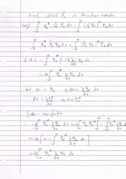

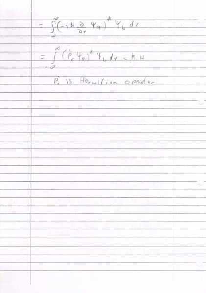

hello
i have to proof that Px (linear momentum operator ) is hermitian or not
i have added my solution in attachments
please look at my solution and tell me if its correct
thank you all

There's a sign error in the last expression of the first page, but you "fixed" it in the next expression.
This looks OK to me, but of course you should explain why ##\left.\psi_b^*\psi_a\right|_{-\infty}^\infty=0##.
What is the domain of the linear momentum operator that you're looking at? You can't just look at arbirary wave functions, because then ##\psi_b^*\psi_a\vert_{-\infty}^{+\infty}## will not be zero. You need to restrict to special wave function which do have that property.
Another solution is that you use "distributional differentiation".
thank you for your answers
if i take a special function which satisfy the property then is my solution ok?
Yea, it looks OK to me.
ok thank you very much
