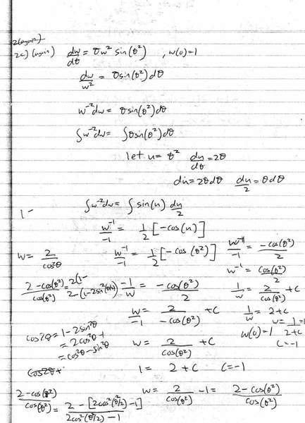

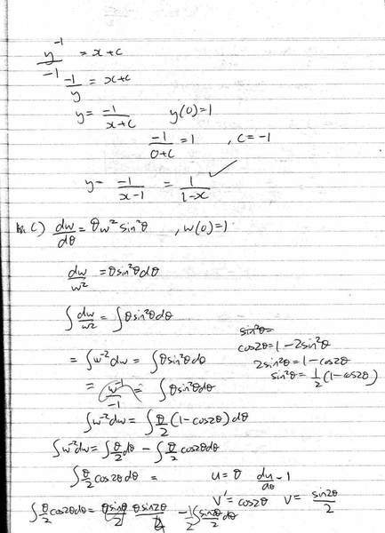

For the following problem
\frac{dw}{d\theta}=\theta w^{2}sin(\theta^{2}), w(0)=1
I am not able to obtain the solution
w=\frac{2}{1+cos(\theta^{2})}
Can anyone point out my mistake?
I have attached my working out in a picture format below (may need to enlarge it)
thanks
thanks
sin(θ^{2}) ≠ sin^{2}(θ)
Be careful where you put the exponents when using trig functions. It makes a difference for integrating and differentiating as well.
sorry wrong piece of paper.
Please look at this new attachment and inform me of my error

You forgot the arbitrary constant.
nothing wrong with the u-substitution and integration, however on the right side toward the bottom of your page, one step reads:
1/w = 2/(cos(Θ2)) + C
What I suggest:
1). ALWAYS isolate the function variable first (in this case w(Θ)) before solving for the arbitrary constant (in this case C).
In other words - rather than what it reads now: 1/w(Θ) = ...
rearrange the equation such that it reads w(Θ) = ...
THEN solve with the initial value w(0) = 1
2). AlSO (and more importantly) keep in mind that any value multiplied by an arbitrary constant is still the value of the arbitrary constant (e.g. 2 * C = C)
So putting these two suggestions together, rewrite 1/w = 2/(cos(Θ2)) + C such that it reads 1/w(Θ) = ... then one ENTIRE fraction. Then flip the fractions on either side so that it reads w(Θ) = ...
THEN solve with the initial condition w(0) = 1.
hope this helps
