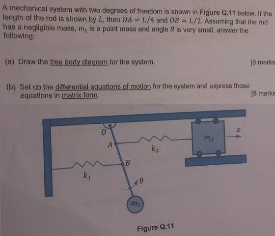

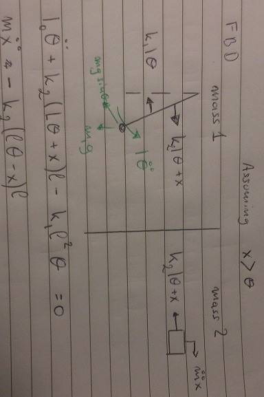

I am struggling with the following question, it is a mixed (lever and linear) 2DOF vibration problem, something I never came across before. I am afraid I am missing something on the FBD, thus the differential equations of motions are wrong.

You did the right things to set up the equations of motion, but what are the horizontal displacements of the springs ##k_1## and ##k_2##?
They are not attached at a distance ##L## from the pivot, so they are not ##L\theta##.
Also, be careful with the signs. You have the amount of stretch in ##k_1## as ##L\theta +x## in one equation and ##L\theta -x## in the other. They can't both be right!
I see, distance L for each spring is given in question, is it k2 (L/4)θ+x and k1(L/2)θ ?
In which case the differential equation of motion become (now with correct signs)
Iθ + k2 (L/4)θ+x - k1(L/2)θ =0
mx - k2 (L/4)θ+x =0
The L/2 and L/4 are right.
With θ and x defined as in the diagram in the question, (L/4)θ and x are both positive to the right. So, is the extension of the spring (L/4)θ+x or (L/4)θ-x ?
