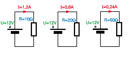

If you put your 233 ohm resistor across a 9 volt battery, it drops 9 volts. Voltage drop = voltage across resistor.
Resistor "see" 9V across his terminals because you connected a 9V battery directly across a single resistor.
So in this case resistor will only change the current in the circuit. Because how can a resistor change the battery voltage?
We have a different situation when we add another resistor in series

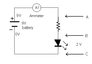

I was in the middle of drawing a pic when you replied ...
seeing a circuit often helps visualising the problem :smile:
How did you make that schematic? I don't see anything underneath "reply." Is that another program you're using and you're just hitting the paperclip icon to copy it?
so we know there is 9V across the resistor and LED ... ie. the voltage measured between A and C = 9V
the datasheet tells us that there will be a 2V drop across the LED ... between B and C
that means there must be a 7V drop across the resistor ... between A and B
BECAUSE all the voltage drops must add up to the total voltage applied to the circuit :smile:
Dave

so some things you can now work out
here's a problem for you to solve ...
in a series DC circuit, the current is measured the same everywhere, therefore there is 30mA through the LED, through the resistor and through the wires coming from and to the battery
Using Ohms Law --- R = V/I
knowing that the voltage drop across the LED is 2V and the current is 30mA ---
What is the resistance of the LED ?
knowing that the voltage drop across the resistor is 7V and the current is 30mA ---
What is the resistance of the resistor ?

I think the total voltage drop in the circuit is = to the supply voltage in a simple dc series circuit like this. The led has a certain resistance, as does the passive resistor. The voltage drop across each will be equal to V=I*R.
The current that is flowing in the circuit will be equal to I = V/R (where R is the total resistance in the circuit) The voltage drop across each resistance, is according to the resistance of of that part of the circuit, and the current flow will be the same in all parts of the curcuit. Maybe neglible in most circuitry is the fact that the wires or other conductors like circuit board traces also have some resistance to the current flow.
  • #36
Ohm's law is a law not a suggestion.
For semiconductor diodes and LED's though R is a function of both current and temperature, and maybe even incident light, so the arithmetic gets more complicated than for a simple ideal circuit element.
Opto devices excluded they're not active so much as they're simply nonlinear.
