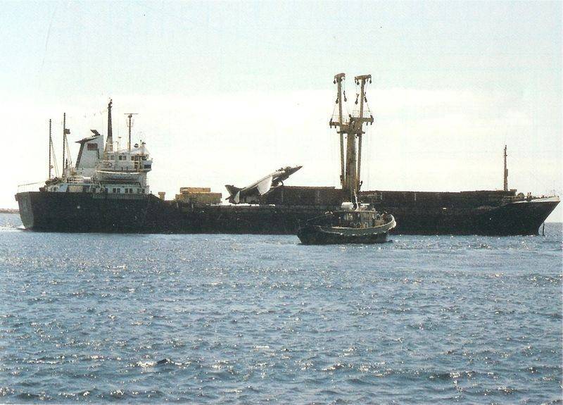

In another Physics link - in 1983 a harrier got lost on an exercise and ended up landing on a Spanish container ship near Teneriffe. The big flat crate it landed on was carrying the base plate for one of the British Telescopes on La Palma. There is a photo of the landing in the tea room there.
