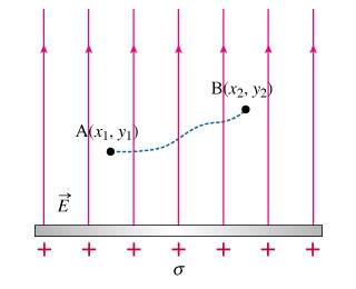

Let {\rm A} = \left(x_1,y_1 \right) and {\rm B} = \left( x_2,y_2 \right) be two points near and on the same side of a charged sheet with surface charge density + \sigma . The electric field \vec{E} due to such a charged sheet has magnitude E = \frac {\sigma}{2 \epsilon_0} everywhere, and the field points away from the sheet, as shown in the diagram. View Figure
Part A
What is the potential difference V_{\rm AB} = V_{\rm A} - V_{\rm B} between points A and B?
Part B
If the potential at y = \pm \infty is taken to be zero, what is the value of the potential at a point V_A at some positive distance y_1 from the surface of the sheet?

V_{\rm AB}= -\int _B^A \vec{E}\cdot d\vec{l}
Part A.
V_{\rm AB} = V_{\rm A} - V_{\rm B}= \left(-E\right)\left(y_{1}-y_{2}\right)
Part B.
I figure I'd use the equation I got in part A and set the bottom of the E field at y=0.
In which case
V = -E (y_1 - infinity) = infinity
am i on the right track?
Looks right to me.
