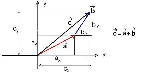

I see... I seriously suggest that you read your book or notes about vectors.
Velocity is a vector. It has magnitude and direction. A vector can be represented in a Cartesian coordinate system by an arrow, inclined with an angle with respect to the x axis. Its components are projections on the axes, see figure. The red vector, \vec a has components ax and ay, the components of the blue vector \vec b are bx and by.
When you add vectors, their x and y components add separately. The resultant vector \vec c=\vec a +\vec b has the components cx=ax+bx and cy=ay+by.
Never add x component to y component!
The momentum is vector, too, \vec p=m \vec v Its components are
px=mvx and py=mvy.
The total momentum of two objects is the sum of the individual momenta. \vec p=\vec p_1+\vec p_2. That means two equations for the components:
px=p1x+p2x and py=p1y+p2y.
Conservation of momentum during a collision means that the total momentum before the collision is the same as the total momentum after the collision.
\vec p(initial)=\vec p(final)
That is valid to the x and y components separately.
Now we start with this problem, writing out the individual components of the initial and final momenta for both objects.
