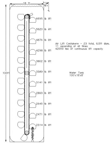

I work at a manufacturing plant. One by product of this plant is the issuance of 2000 cfm (cubic feet per minute) of clean air. It is determined that this air could be released from as small as a 3 inch pipe with no adverse harm to the manufacturing process. It would be exhausted at 100 psi. So it got me thinking, how can this be put to use?
Please look at the attached diagram-
My general idea is to build a 100 ft tall (x18x8) tank and fill it with water. You see three shafts; top, middle, and bottom. I have received some information from Winergy, a subsidiary of Siemens regarding gearbox/generators. They manufacture a gearbox that requires 16 kiloNewton meters (11,800 ft lb) of force to operate. This, in conjunction with a matched generator, will produce 100 kilowatts of power, so that a total of 300 kw can be realized in this system.
The input of 2000 cfm at a water depth of 100 ft would mean that each cubic foot would be compressed to approx. one-fourth its surface volume. This means that the 2000 cfm will be entering the bottom of the tank at 500 cfm, then expand to 2000 cfm as it rises to the top of the tank.
A roller chain with “air lift containers” could be attached to the shafts as shown. These containers could be made of carbon fiber, plastic or maybe aluminum. If each were a hollow sphere of 6.5 feet diameter, then the volume would be 143 cubic feet. One factor I have not considered yet (infant stage of idea) is the volume loss of the sphere once the “top” is cut off to resemble a deep bowl. For discussions sake, ignore that at this time. One cubic foot of air will lift 62 pounds to the surface. You see numbers next to each of the rising containers. I roughly calculated what the lifting capability would be for each ascending container at points along the roller chain (snapshot of system). As the air enters the base of the tank it will only fill one-fourth of the container and expand, filling the container as it rises, becoming nearly full at the top of the system, and gaining lift capability as it rises.
Each of the 3 shafts would need to rotate at 60 rpm to generate the 100 kw each. I do not know if this can be achieved. If the cog on the shafts were 2 ft circumference then the containers would need to rise at 2 ft per second. This seems feasible to me to accomplish. I have not located answers regarding natural rising speed of air in water, or filled containers for things such as salvage diving, etc.
With these figures, I calculate that the total, constant lifting capability would be approx. 42,000 lb. If the three shaft require 11,800 ft lbs each, totaling 35,400, then am I close in believing that this can work? I understand that system weight, drag, and water drag need to be considered. Regarding such issues as water drag, it can be minimized once the system is up and running and the water is moving in the same direction as the system. Also, right in the middle of the tank, between the ascending and descending chain, I have drawn a vertical line that represents a separator that would lessen the commingling of water.
One other issue I do not understand how to calculate is the cog size and how it changes things. I had someone tell me the following –
With the chain on a sprocket radius equal to 0.32, there is only 13,370 ft-lbs of torque generated by the buoyant force of 42,000. This is confusing to me. Remember that I had calculated a circumference of 24 inches, which could be adjusted of course. I just decided on that to make calculating the 2 ft per second rise simple. Am I to assume that the larger the cog the less torque?
Anyways, I would welcome any thoughts on this idea.
Thanks so much for reading this. Go easy on me though. I believe that I have a decent amount of common sense, but no great intellect, especially in the area of physics and mechanical engineering.

First off, does the manufacturing process require that you release the air at a depth of 100 feet or are you doing that soley to produce energy from it? At about 60 PSI and 500 CFM, you need an enormous compressor to generate this airflow. And is the top of this tank open to atmosphere? And where do you get that 100 kW? 100 kW / 16 kN-M = 6.5 m/s, buy you said you are only getting 2 ft per second (about .5 m/s). Power is force times distance over time.
Take a step back and remember: conservation of energy applies. Whatever you can generate you have to input in compressor power. Are you recovering energy that has to be wasted by your manufacturing process, or are you increasing the energy dissipation in order to recover more? At a bare minimum, with a 50% efficient compressor, and unknown efficiency generator and turbine, generating 300 kW of electricity will require a 600kW compressor. Does your manufacturing process include a 600 kW compressor?
If you tell us more about the process requirement, I can probably advise you of the best way to recover energy from it (if it is possible at all).
russ is right, if your air doesn't come out of the manufacturing process compressed then the energy used in your compressor will be more than the energy out. However, assuming that the air comes out compressed then you do have a large amount of energy available.
The amount of energy is equal to the pressure times the volume: 500 cfm 100 psi = 160 kW
Of course, you will not be able to extract all of that energy, I don't know exactly how efficient these kinds of devices can be, but I would guess no more than 75 kW out in the end.

Hi kitarney,
If it already comes out as 2000 cfm at 100 psi then the water will not compress it to 500 cfm. If you compressed it to 500 cfm then it would be closer to 400 psi.
In any case, uart is correct, just use a pneumatic motor to run a generator. Should be more efficient and you won't have to worry about cleaning out the algae that will grow in a huge tower of water

100 feetH2O = 43 psi.
Since your air going into the tank is 2000 cfm at 100 psi it is already more pressurized than the 43 psi at the bottom of 100 feet of water. Your air will actually expand, not compress. You would only get the compression you are talking about if your 2000 cfm were at a low pressure instead of 100 psi. In that case you would be completely unable to inject your air into the bottom of the tank without first compressing the air (which would defeat the whole purpose).

You are saying that you have both 2000 cfm at 100 psi and 500 cfm at 100 psi. It can't be both at the same time. When the air actually comes out of your plant, what is the airflow and pressure?
You also didn't specify if that pressure is gage or absolute (we're assuming gage). In any case, 100 psi is 6.8 atm, but 100 feet of tank is only 43 PSI or 3 atm (+1 from the atmosphere itself). In other words, you don't inject air into the tank at 100 psi, you inject air into the tank at 43 psi. To do that, you run the air through a nozzle, where it loses about half the energy being converted. Better off running it through a turbine in at 100 psi and out at 43 (or why not in at 100psi and out at atmospheric and not bother with the tank?).
At 100 feet one cubic foot of air is compressed to one-fourth its volume. With this in mind then, would it not be true that the 2000 cfm would actually enter the tank at 500 cfm then expand to 2000 cfm when it rose to the surface?
No. Air has one volume at a time. When you inject it, it is either 2000 cfm or 500 cfm, not both. Again, what is the output of your plant, in airflow and pressure?

No, whatever a buoyancy motor could recover, a pneumantic motor could recover much, much more. What you are trying to do is akin to driving your car through molassas. All you're doing by adding the water is adding unnecessary resistance.

The largest compressor that Ingersoll Rand makes is just barely large enough to provide the specified 2000 cfm at 100 psi and that's without first using the air in a manufacturing process! http://air.ingersollrand.com/IS/modelComp.aspx/item/12816
Those specs require a 400 hp (300 kW) compressor on their own (that's in line with Dale's estimate: 50% efficiency is pretty typical).
