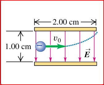

An electron is projected with an initial velocity of 1.6x10^{6} m/s. If the electron just misses the upper plate as it emerges from the field, find the speed of the electron as it emerges from the field?

I am stuck trying to figure out the magnitude of the electric field, once I can figure this out I know how to solve the problem. Any pointers on how to find the magnitude of the electric field?
Use ordinary kinematic means to determine the velocity.
You know the speed, hence how long for it to emerge.
In that time you also know the deflection so you can determine the acceleration.
That acceleration then yields the additional sideways component of velocity to calculate it's speed at that point right?

You don't need to know the magnitude of the electric field.
I was planning to use Vf^2 = Vo^2 +2ad to find the final velocity, but I am missing the acceleration component. To find the acceleration I wanted to use F = ma (knowing the mass of the electron). But I would need the magnitude of the electric field to find the force from E = F / q.
So how would I do this without using the electric field? I don't know what you mean about using the "deflection" to find the acceleration. How would I calculate that?

The horizontal velocity to the end of the plate gives you time.
Use the distance, acceleration, time relationship to determine acceleration.
Then you can use your V2, acceleration and distance.
Thanks for the advice, but this does not work. I get the answer wrong, the magnitude of the electric field is 364N/C, I am just not sure how to find it. When I use this electric field with the method I stated above I get the right answer. I just can't figure out how they got 364N/C :(
Once you determine the acceleration from the trajectory, then you can use f = ma to determine field intensity.
They ask really though for just the speed.
That equals (Vx2 +Vy2)1/2

Yes! Thank you so much, I figured it out now =)
