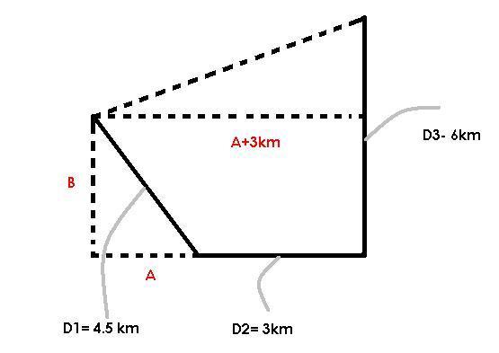

No, we did not. The work was taken up much differently then the way you are saying it, and the example i have from my tutor is a much different question. So for all numbers I have labelled it as so. Also, my scale is 1cm equals 1 km. So I have; Delta D1= 4.5cm Delta D2= 3cm Delta D4= 6cm and from that point I have drawn 30 degrees west of north.

It is not as much the problem that I don't understand because I have it drawn correctly. From my last point, the resultant vector is 30 degrees, how do you find the displacement from that point, to my beginning point?

Eek, I wish I could show you what I have drawn because I do not know how to explain what I have done.
You can attach images using the "manage attachments" option in the "go advanced" mode.
If you've drawn something on paper, can you describe it in detail ? If this is on square (graphing) paper, perhaps you can tell the coordinates of the ends of each arrow ?
Says that it is too big
How did you draw it ? On Windows you can just make a simple sketch in Paint (keep the size of the workspace to less than say 200 X 150 pixels) , save it as JPEG and attach it. If you save it as a BMP, it may exceed the filesize limit.
k that might be my problem
I should have noticed this earlier - and I apologize for not doing so - but there's a mistake in the question. It does not tell you the distance traveled in the last leg; only the direction. The question is incomplete.
As for the figure above, you'd want to calculate what A and B are. First notice that ABD1 is an isoceles triangle, with A=B. Since you know D1, you can calculate A (and hence B) using the Pythgoras theorem. As for the last bit (D4), there is not enough information in the question.
