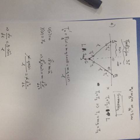

Consider 2 balls A,B on the same line . and they are connected to a third one G with a rope L. AG, AB. now the system monves in the effect of the mass of G and its projection to the line AB is in the middle. No friction. mass of A=mass of B=m and mass of G=2m
.FInd the time of impact and the velocity of G at that time A-B move only on the x axes.
Dont understand what it means the system moves on the effect of the mass G. Also I know the only forces are From the rope. 2 on the G ball and 1 in each of the balls.I understant i have to apply conservation law of energy but how? What is the potential energy(what if the force) ?

so what is the force acting on G 2mg?
Yes, plus the tension from each string.

So far so good?

Manolisjam said:
So far so good?
Nope. Why is T1 = mg = T2? Furthermore, the tension is not constant as mass G descends. If I were you, I would stick to the original idea of energy conservation and not try to derive the equation of motion. Note that the time of impact depends on how far apart masses A and B are when they are released (I assume) from rest. Does the problem give that distance?

From symmetry? ALso why isn't the tension constant? the rope isn't elastic .

Symmetry demands that the tensions be equal, T1 = T2, but not that they are equal to mg which is what you had.

I agree, but neither Ty is constant. Is the acceleration constant or does it depend on θ?

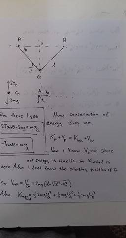

You have to consider two free body diagrams, one for the hanging mass G and one for A. You get two equations of motion. Note that the accelerations of A and G are different but related through angle θ. That relation you have to derive starting from y = (L2 - x2)1/2.

Because in the vertical direction, the forces acting on mass G are 2Ty up and 2mg down. What is the net force on G? What is the net force equal to according to Newton's 3rd law?
You don't really need to find T. You want to write two equations involving T the masses, and the accelerations. These would be Fnet = Ma in the vertical and horizontal directions. So in the vertical direction, you get 2T cosθ - 2mg = - 2maG. Can you write an analogous equation for the horizontal direction?

I understand that. However, there is horizontal tension Tx that accelerates A and B in the horizontal direction.

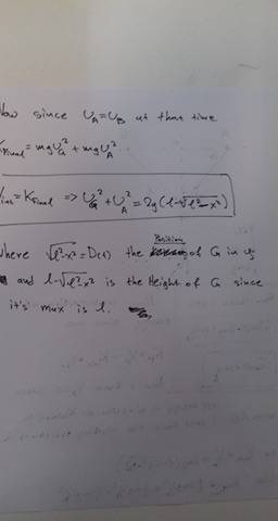

i osted my progress so far.
Let's say the gravitational potential energy U is zero when all three masses are at the same height and mass G is at the origin O. What is the potential energy when the distance between A and B is 2x and mass G is distance y below the origin? How are x and y related?
