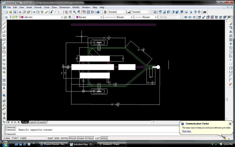

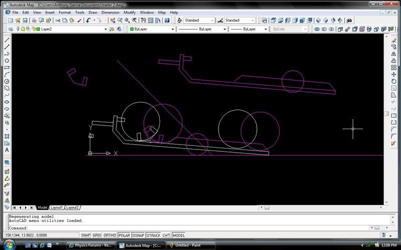

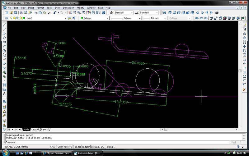

I am building a motorcycle trailer. I have 2 x 2 square tubing that is about 1/16 thick and it will be about 6 and 1/2 foot long the trailer will need to hold 433 that is how much my motorcycle weighs. Does any know of a site or somewere that I may find this information so that I can start on it. i just need to find out the weight that it will hold please post a site if you know one thank you
please does someone know were i can find out this information.
If you draw us a picture, it might be quit helpful. In fact, you'll probably get some very useful information and numbers with a decent picture.
how would i post a picture the only drawings I have are in auto CAD?

antzgarcia: I notice the half axle you are using is also a shock absorber. I think the minimum dynamic amplification we should use is daf = 2.50. And I think the minimum yield factor of safety we could use is FS = 1.70. We will see if anyone disagrees. Therefore, your square tube wall thickness is too thin for the rear beam spanning across your trailer. Using the above minimum factors and mild steel, you would need a rear beam wall thickness of t = 6.35 mm. However, using daf = 3.0 and FS = 2.0 would give you a rear beam wall thickness of t = 12.7 mm. If you could state the material specification of your square tubes, it might affect the answers.
