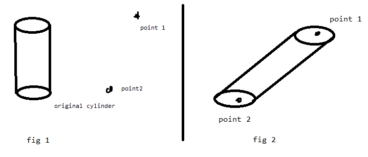

Hello all, I know 3d gradients are often represented by gradient vectors but in the current project I am working on it would be a lot more convenient for me to do it this way if possible, the X gradient is given by Δy/Δx, and the Z gradient by Δy/Δz how can one obtain the Y gradient?
I tried endY-beginY. in case your wondering.

this is for a program I am writing, in it there is a cylinder consisting of rows of circles, its essentailly a plane wrapped in a circular shape using trig. now i need to get that cylinder to stretch between two points, so I am using the straight line equation to do this. so there isn't a function where I can use partial derivatives. I am trying to extend the 2d line equation to 3d in non parametric form (delta x over delta y). I have gotten the z and x shift values using what I said earlier but I can't figur out how to do the y shift. If you can think of another way to do what i need to do I am open to change in the method.Reason I said End.Y/Begin.Y was because i tried to get the gradient relative to the xz plane, so y2-0/y1-0.

You are trying to describe the deformation of a cylindrical surface. Does the surface stretch axially? Does the surface stretch radially. Is there angular shear? Is the deformation axially symmetric? Or, is the deformation totally arbitrary?

Thats what I am trying to do, what I did initially as a temporary fix was to add offset=gradient*(cylinder vertex height) to each vertex in the cylinder. which worked for x and z shifting. Is there a better way to do this if the y gradient can't be obtained?
Is it just the axis of the cylinder that is being displaced (by shearing the cylinder like a deck of cards), or is there more being done, so that the circles don't remain circles, or the radius of the circles increases, or the vertical distance between the circles gets larger?

like the deck of cards, that's just the way I am trying to do it, is there a better way?

Is this a solid cylinder or a thin tube?
chet
I said earlier a plane wrapped cylindricly therefor thin tube.

You are trying to determine the deformation gradient tensor for the deformation you illustrated in post #9, correct?

Well, if I understand the problem correctly, I'll try to lead you through the solution.
Let x0, y0, and z0 represent the coordinates of a material point on the cylinder before the cylinder has been deformed, and let x, y, and z be the coordinates of the same material point on the cylinder after the cylinder has been deformed. If θ represents the angle that the axis of the cylinder makes with the z (upward) direction in the deformed configuration of the cylinder, please express x, y, and z in terms of x0, y0, and z0 and θ. (Assume that, in the deformed configuration), the axis is tilted in the x direction.

Found a soultion
CylinderPointPos = OriginalCylinderPointPos + ((positon2 - positon1) / RingCount * RingHeight);

[tex]x=x_0+tan\theta z_0[/tex]
[tex]y=y_0[/tex]
[tex]z=z_0[/tex]
So, if two neighboring material points in the original configuration of the body are located at x0 and x0+dx0, y0 and y0+dy0, and z0 and z0+dz0, these same two neighboring material points in the deformed configuration of the body are located at x and x+dx, y and y+dy, and z and z+dz, with
[tex]dx=dx_0+\tanθ dz_0[/tex]
[tex]dy=dy_0[/tex]
[tex]dz=dz_0[/tex]
So,
[tex]\left( \begin{array}{c}dx\\dy\\dz\end{array} \right)=\left( \begin{array}{ccc}1&0&tanθ\\0&1&0\\0&0&1\end{array}\right)\left( \begin{array}{c}dx_0\\dy_0\\dz_0\end{array} \right)[/tex]
The 3x3 matrix is the deformation gradient tensor components.
