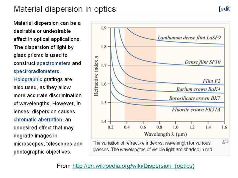

Bob S

I have looked at the thumbnail, and doesn't the graph show an inversely proportional relationship between the index of refraction and wavelength in the region of visible wavelengths?
Look at the two plots in above html. The index of refraction increases at higher frequencies (increases at lower wavelengths). But is not a hyperbola (inverse proportional relationship between refraction index and wavelength).
No. Inversely proportional is when the graph of the index of refraction vs. (1/wavelength) is a straight line throught the origin.
