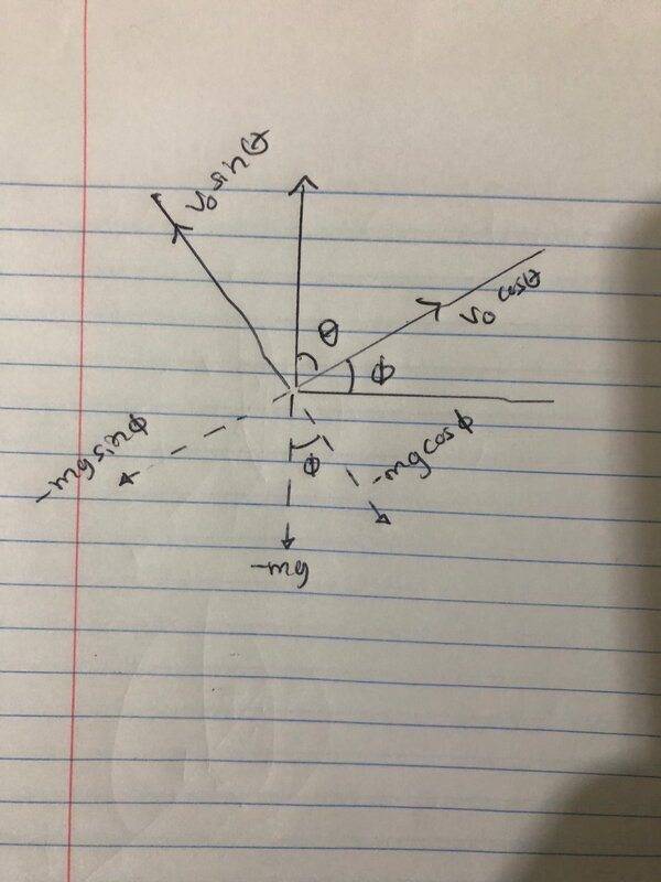

Suppose a ball is thrown straight up with an initial speed of ##v_i## on an inclined plane, where the plane is inclined at an angle of ##\phi## above the horizontal and the ball's initial velocity is at an angle ##\theta## above the plane.
##F=ma##
I understand how the diagram below determined the ##x## and ##y## axis for the velocity vectors but I don't understand the gravity vectors. What I don't understand about the gravity vectors is why is ##-mg## in the ##y-##axis equal to ##-mg\cos\theta## and the ##x-##axis is equal to ##-mg\cos\theta## even though the diagram for the velocity vector has the ##y-##axis as ##v_0\sin\theta## which is exactly on the same axis for the gravity vector so shouldn't the gravity vectors ##\cos## and ##\sin## be flipped? Also, I don't understand how the ##\phi## angle below the horizontal was determined in the diagram. Shouldn't that ##\phi## be instead ##\theta##?

There is no ##mg\cos\theta## in the diagram. The weight ##mg## down is correctly resolved into components where the ##x##-axis is up the incline and the ##y##-axis perpendicular and away from the incline and ##\phi## is the angle of the incline. Note that ##\theta## is complementary to ##\phi## so that ##\cos\phi= \sin\theta## and ##\sin\phi=\cos\theta.##
Angle ##\phi## below the horizontal is equal to angle ##phi## above the horizontal because they have their sides mutually perpendicular. That's a theorem from geometry. You can see why that is if you imagine the angle ##phi## above the horizontal being decreased to zero in which case angle ##\phi## below the horizontal will correspondingly go to zero.

Ops, I meant to say ##mg\cos\phi## and ##mg\sin\phi##, not ##mg\cos\theta## and ##mg\sin\theta## . Why are they complimentary even though that in the diagram is clear that ##v_0\sin\theta## and ##-mg\cos\phi## are on the same axis so shouldn't they both have the same trig function of ##\sin##?
Also, do you know of the name of the geometrical theorem?

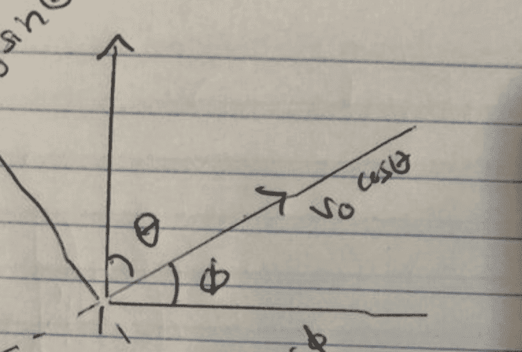

Complementary means ##\theta +\phi=90^o.## It sure looks like it in your diagram.
As I said before, ##v_0\sin\theta=v_0\cos\phi## because the angles are complimentary, so they do have the same trig function.
I do not think that the theorem has a name. It was proven by Euclid who lived 23 centuries ago. It suffices to say that "two acute angle that have their sides mutually perpendicular are equal." It's a good one to remember.

Is this a translation? I suspect it is thrown 'straight up' in the sense that its trajectory is in a verical plane orthogonal to the plane of the slope. It is thrown at an angle θ+φ to the horizontal, not vertically.

Yes, correct. I am unable to edit the question so I am unable to add to it but I should add that ##\theta > \phi##.

No, it's not that ##\theta > \phi##. That may or may not be true. It's that ##\theta + \phi\leq \frac{\pi}2##.
