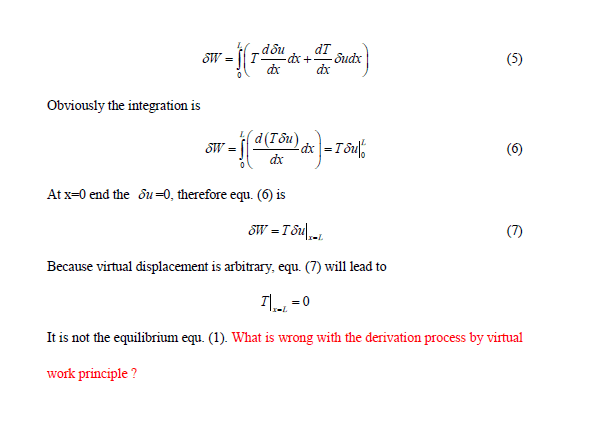

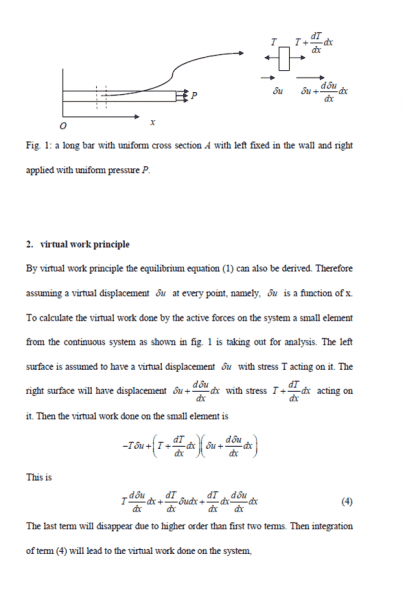

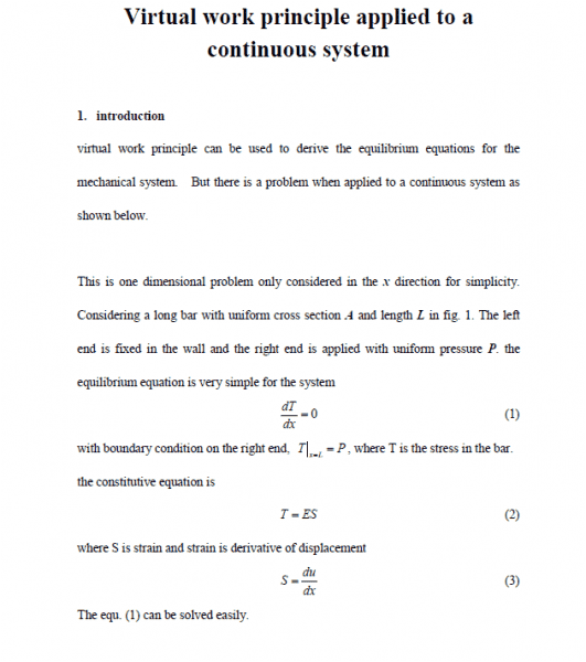

dear all, the virtual work pinciple can be used to derive the equilibrium equations for the mechanical systems. however, when I want to apply it to a continuous system, I found it can not give out the simple equilibrium equations. there should be something wrong with my thinking. I expect some expert could give me some advice. thanks very much.
the problem detail is shown in the pictures:
Typeset page titled 'Virtual work principle applied to a continuous system' with an introduction, equilibrium equation dT/dx = 0 (1), constitutive equation T = ES (2), and strain S = du/dx (3).

Handwritten-style typeset derivation of the virtual work principle for a string, equations (5) to (7), with a final red question asking what is wrong with the derivation.
  • Page of typeset text titled Virtual work principle applied to a continuous system, with section 1 introduction presenting equations (1) dT/dx = 0, (2) T = ES and (3) S = du/dx for a long uniform bar fixed at the left end and loaded by pressure P at the right end.

  • Diagram of a long bar fixed at the left wall and pulled by pressure P at the right end, with a small element showing stress T, length dx, and displacement du; equations for virtual work, text below.

  • Typeset derivation of the virtual work principle for a string: equations 5 to 7 integrate T times the variation of du/dx plus dT/dx times du, giving T du evaluated from 0 to L, then T at x=L equals 0, with a red question below.

The virtual work needed to compress (or elongate) the small element is the stress times the amount of the compression. So,
[tex] \begin{align}<br /> &TA(\delta u+\frac{d \delta u}{dx} dx - \delta u)=TA\frac{d \delta u}{dx} dx,\\<br /> &\delta W=\int_0^L TA\frac{d \delta u}{dx} dx=TA\delta u|_{x=0}^{x=L}-A \int_0^L \delta u\frac{dT}{dx}dx =TA\delta u|^{x=L}-A \int_0^L \delta u\frac{dT}{dx}dx,<br /> \end{align}[/tex]
where we use integration by parts.
As [itex]\delta u[/itex] is arbitrary, we have [itex]\frac{dT}{dx}[/itex] anywhere other than the open end[itex]x=L[/itex]. Happily we know that [itex]T=P[/itex] at [itex]x=L[/itex]. We get equation (1).
