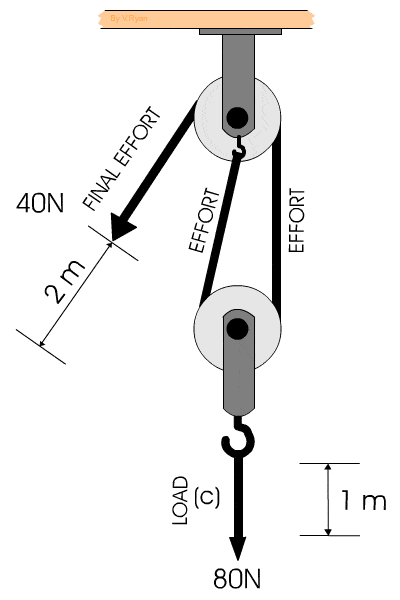

Here it is @erobz ,
##L = a + 2s + \Delta 2s+ 2b + l + \Delta l##
Many thanks!
Callumnc1 said:
Hi @erobz ,
Is the reason why you used arrows for this ##z \to z+ \Delta z## because if you use equal sign then
##z = z+ \Delta z##
##z = z+ z_f - z_i##
##z_i = z_f##
Oh which is conservation of the quantity z anyway!
Many thanks!
Its just shorthand math notation for saying ##z## goes to ## z + \Delta z##. The variable ##z## wouldn't equal ## z + \Delta z## except in the case that ##\Delta z \to 0##

Callumnc1 said:
Here it is @erobz ,
Many thanks!
Ok, now equate the two equations through the variable ##L## and cancel the terms. What are you left with?
Edit: keep the ##\Delta## next to the ##s##

The first one we derived with that one. they both equal ##L##. You are attempting to figure out how the changes in each variable relate to each other.
Thank you for your reply @erobz !
That must be ##L = a + 2s + 2b + l## and ##L = a + 2s + \Delta 2s+ 2b + l + \Delta l##
So
##a + 2s + 2b + l = a + 2s + \Delta 2s+ 2b + l + \Delta l##
## 0 = \Delta 2s + \Delta l##
## -\Delta 2s = \Delta l##
## 2(s_f - s_i) = l_f - l_i##
Many thanks!

Move one of them to the other side of the zero. And if you want to know how far pulley B moves in terms of a how far pulley A moves solve for ##\Delta s##.
Again. Keep the ##\Delta## touching the ##s##. They are stuck together. Joined at the hip! don't put that 2 in between them.

## -2\Delta s = \Delta l##
Many thanks!
Thank you for your help @erobz !
Just a side question, how were we allowed to add the ##\Delta## to ##s## and ##l## then set them equal to each other?

Because the change is unsigned. It could be a positive change. It could be a negative change. It may appear like were adding to both lengths but is turns out we weren't. Notice the equation dictates a positive change in the variable ##l## ( ##\Delta l > 0##) demands and negative change in ##s## ( ##\Delta s < 0 ##), and visa-versa.

No. You can add it to anything. The only constraint needed is that you have a relationship between some variables. It's simply saying we have this relationship between all these variables, lets pick some or, all that can change and change them a bit from where they currently are valued at, and see how they respond to each other. How it all pans out or the end goal is specific to each situation.
The main motivation is derivatives and differential equations, where you are looking for the change in one variable w.r.t a change in another variable. You've got time to learn all this. You don't have to figure all this out yesterday.
