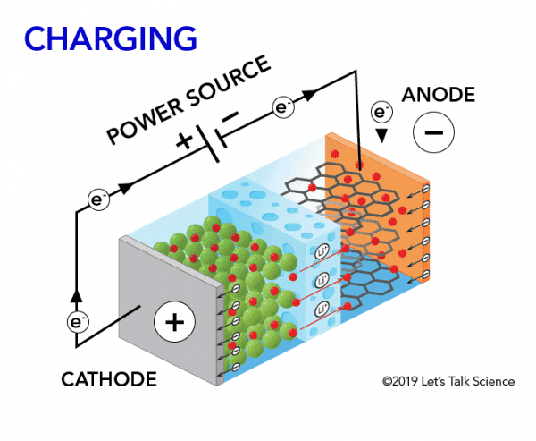

Thanks guys for all the discussion. I understand now the drifting velocity is the actual motion speed of electrons in a copper wire in a DC circuit. Water flow analogy is not right. Misleading. Now I am thinking a lithium battery circuit as below. So when power source is ON, electrons start moving from cathode to anode via power source and Lithium-ion are moving from cathode to anode through intercalate. As the conclusion we get from previous discussion, the actual electron's moving speed is slow . I am now looking at below Lithium batter charging process. Can I say the reason we need wait hours to do the charging is because we need to wait those electrons to arrive anode (via power source) and lithium-ions to reach anode ( via Electrolyte )?

The total current is of course not that small, because you have a huge number of electrons (and in this case also positive ions) around. You can easily make the current (i.e., the amount of charge going through the wire per unit time) very large and shorten the time for charging your Li battery. The only trouble is that this may destroy it, and that's why we rather charge our cell phones with lower currents to prolong the lifetime of the battery.

Hi, Vanhees71. Thanks for your answer. A bit difficult for me to understand exactly. Can you simplify and tell me what is the difference between the 2 scenarios. A - Everything same but low voltage B everything same but high voltage. I mean in the charging circuit as the diagram. What is the difference in terms of the motion of the electrons, and the lithium-ions as well. Their actual drifting velocity is different?

Note that while electrons may be indistinguishable, Li nuclei are not. Li-6 cations have practically the same chemical properties as Li-7 cations, but are very distinguishable. So if you run a Li battery where part of the electrolyte consists of Li-6 and a part of electrolyte of Li-7, can you measure precisely where the division between Li-6 and Li-7 goes inside the battery, and how it moves with battery´ s state of charge?
I talked only about the wire and the electrons in it, not about the ions. For electrolytes of course you have both ions and electrons in the solution moving. The qualitative theory a la Drude is not so much different. No matter whether the voltage is low or high all these charge carriers move but the higher the voltage the larger the drift velocities get and thus also the larger the current gets.
