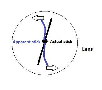

Here is a diagram and the question is if such a phenomenon happens in lens, first with no stick rotation and then with stick rotation. The apparent stick (in blue) is curved in one direction, but the question is about such a possible distortion, also in the opposite direction. The question is also about possible rate change, of the apparent stick curvature (a distortion that changes in time).
Is the lens rotationally symmetrical around the view axis?
Yes

Brilliant, thanks. As they say "a picture is worth a thousand words". Sorry to be grumpy.
We have to assume total symmetry of any lens.
I'm sure you would not expect any measurable distortion. Even without the lens, the distance to the eye from various parts of the rod will be different and you would actually see the ends of the rod with a longer delay to the middle of the rod (which is nearest). So what you see would be different images, separated by much less than 1ns. What sort of rotation rate would you need in order to get a measurable difference in angle? This is along the same lines as early methods of measuring c with a rotating wheel [Fizeau's method] but he used a path distance of 8km and a toothed wheel, rotating at hundreds of rpm.
Using a lens would make the effect even less because the thickness of the glass is, in fact arranged to make the delay along all paths the same, from object to image (which is why it focuses).
