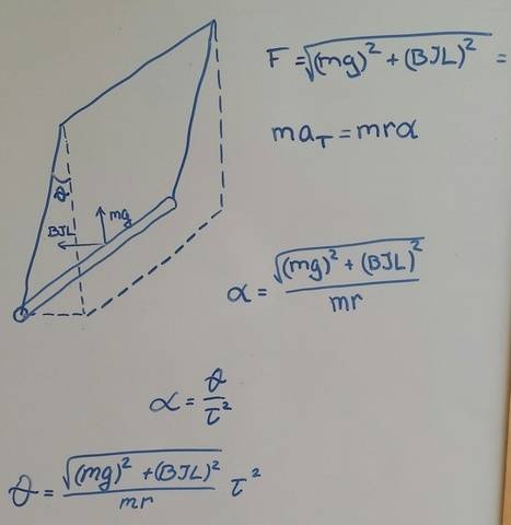

A frame is made of two firm wires of length ##h## and a rod of length ##l## and mass ##m##. This frame can rotate around horizontal axis in uniform magnetic field ##B##. In a short amount of time ##τ## a current ##I## passes through the frame. What is the maximum angle that the frame can make with its equilibrium state? Consider that in time ##τ## the frame moved very little.
##F=Bqv##
Let's denote the total length of the frame by ##L## so that the length is ##L=l+2h##.
The rod is affected by two forces ##mg## and ##F=Bqv=Bq\frac{L}{τ}=IBL##.
The rod is moving because it is affected by a force. This force has horizontal and vertical components.
Ox: ##ILB+mgsinα##
Oy: ##mgcosα-IBLsinα##
So ##F=\sqrt{(ILB+mgsinα)^2+(mgcosα-IBLsinα)^2}##.
Now, I don't know if what I wrote above is true. I've been making a lot of sketches and everything seems correct. But if we look into the first drawing, we can easily see that the sum of forces ##mg## and ##IBL## is ##F=\sqrt{(ILB)^2+(mg)^2}##. I don't know which expression is correct. Also, I don't know if I'm going the right way. Please help.

1. what is force on the bar? Note that you're told the angle will be small. Note also there is the mag. force and gravity. Resolve the force components in the θ direction.
2. write diff. eq. relating torque to rotational inertia and angular acceleration.
Solve this eq. for the angle the bar makes with the vertical as a function of time (linear, const.-coeff. 2nd order ODE).
My answer looks like θ(τ) = ai(1 - cos bτ), a and b constants. i is the current, in lower case to distinguish from I, rotational inertia.
PS Lots of things I don't like about your approach. For starters, there is no B force on the wires, and no g force either since they are assumed massless.

1. I've tried to find this force in my first post, but I don't know which variant is the correct one.
2. Say the rod is affected by the force ##F##, then
##τ=Iα##
##Fh=mh^2α##
##F=mhα##
##\frac{d^2θ}{dτ^2}=\frac{F}{mh}##

Again, the question how to express the net force acting on the rod confuses me the most in this problem. As I've highlighted in my first post, I have two variants of how to find the net force. From your last answer I assume that ##F=\sqrt{(mg)^2+(Bil)^2}## is incorrect, so the right answer according to the diagram below must be ##F=\sqrt{(ILBcosθ+mgsinθ)^2+(mgcosθ−IBLsinθ)^2}## .

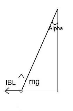

I had to delete my last post since I misdefined the angle theta. Here again:
OK, my turn for a diagram. Yours is making me seasick! :smile: See attachment below. The blue circle is the rod, looked at sideways. The long thin line are the two wires, looked at sideways. Try to determine the components of the two forces mg and Bil on the rod along θ using this diagram.
You keep using the Pythagorean theorem which is not relevant here. You need to find two forces acting on the rod in the same direction so they will just add, not root-sum-square.

g is directed downwards. ( I don't know, is it upwards in the southern hemisphere? :smile:) And Bil is always orthogonal to B and to l.
EDIT: Bil direction shown wrong. What's shown is the component of Bil along θ.
Yeah, g is shown upwards in the diagram you were given. I believe that to be a mistake.

Boy, do I need to eat crow! You are right, the Bil force is always horizontal, being orthogonal to B and l! However, fortunately it changes nothing. The component of Bil along θ is still Bil since cosθ ~ 1 here.
If you make g point up your bar would take off in the up direction like a balloon, wouldn't it?
Anyway, sorry about my misdirection of Bil and good luck with the problem.
