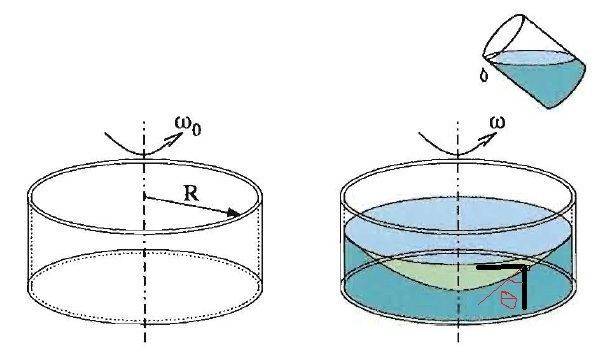

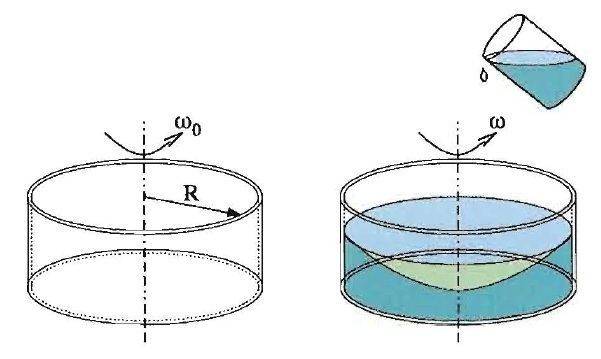

A massive cylindrical container of inner radius ##R## is rotating freely with an initial angular velocity ##w_0##. A liquid of density ρ is slowly injected into the container, until the container is fully filled except the center of the container. The angular velocity of the whole system reduces to ##w## after the injection. What is the container's moment of inertia, while the gravitational acceleration is ##g##?

After I tried to solve the problem by angular momentum conservation, I got stuck on the problem of calculation the moment of inertia of the liquid.
##Iω_0=I'ω##,
where ##I## is the moment of inertia of the containerm and ##I'=I+I_{liquid}##.
I tried to calculate ##I_{liquid}=∫r^2dm##, but had a trouble in the shape of the liquid.
##\tan\theta=\frac{w^2r}{g}## The limit of ##r## is from the position ##r## on the curve line to ##R##, but there is a ##z## dependence of the position r. I don't know how to get the relationship.
However, my way might be in the wrong direction.
Could you give me some ideas?

hi rbwang1225! :smile:
you'd have to do it by integration, slicing the liquid (!) into cylindrical shells of thickness dr :wink:
however, i wouldn't bother …
the question doesn't tell you how tall the container is, so i reckon you're entitled to assume that the dip in the middle is too small to matter, and that the water is just a cylinder :smile:​
(or is the diagram supposed to be showing the dip actually reaching the bottom of the container? in that case, yes you need to integrate :confused:)
OK. Then suppose the liquid forms a cylinder, ##I_{liquid}=\frac{ρVR^2}{2}##.
But the problem becomes we have no height of the cylinder, how could I overcome this?
Sincerely.
